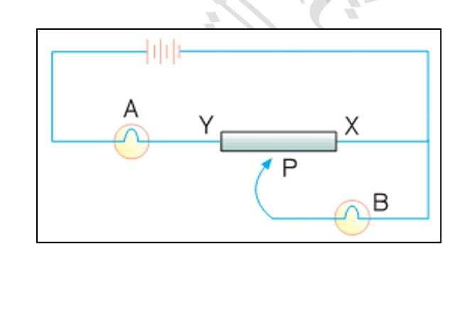

In the circuit shown in the figure, what will happen to the brightness of bulb A and bulb B when the wiper moves from point X to point Y?
[/B]
When the wiper moves towards Y we get smaller resistance, hence the current intensity rises, so the brightness of A increases.
I think the brightness of B will increase too, as the current passing in its branch will increase.
I am not sure about my answer, what's your opinion?
I agree with your answer.
I have just found that my book provides the answer, it is: brightness of bulb A decreases and the brightness of bulb B doesn't change, but there is no explanation.
That's wrong.
Maybe this is the answer to some other similar question and the book just printed it at the wrong place.
