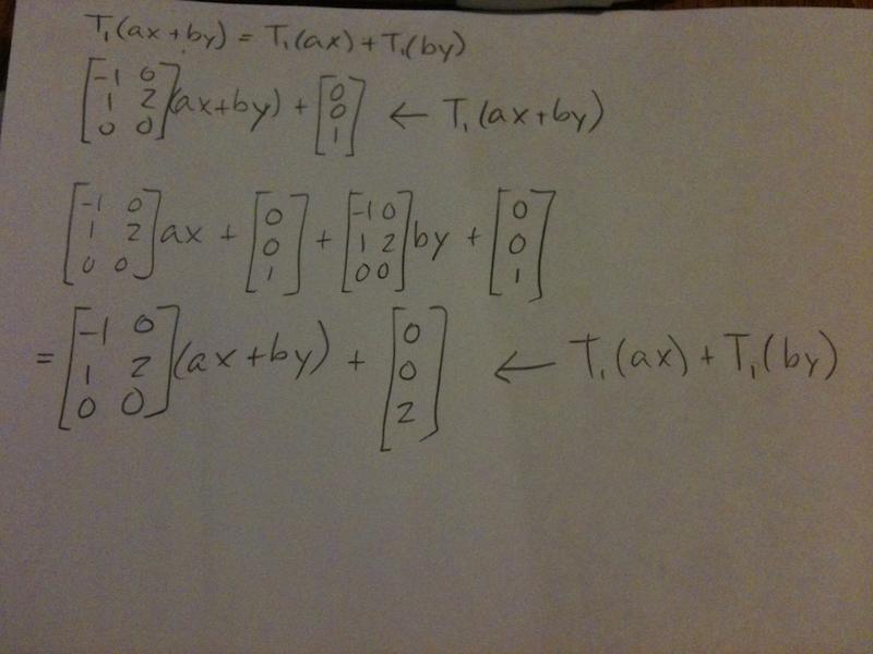

In the previous problem I was asked to identify if a polynomial, such as f(x)=2x was a linear transformation. In that case I checked to see if f(ax + by) = f(ax) + f(by). I figure I would be doing something similar in this case.
I would check to see if T(ax + by) = T(ax) + T(by).
So for problem (A) would I do something like:
and since T(ax + by) ≠ T(ax) + T(by), T1 is not a linear transformation?
You are correct, T1 is not a linear transformation, and your argument is correct/valid.
Thanks!

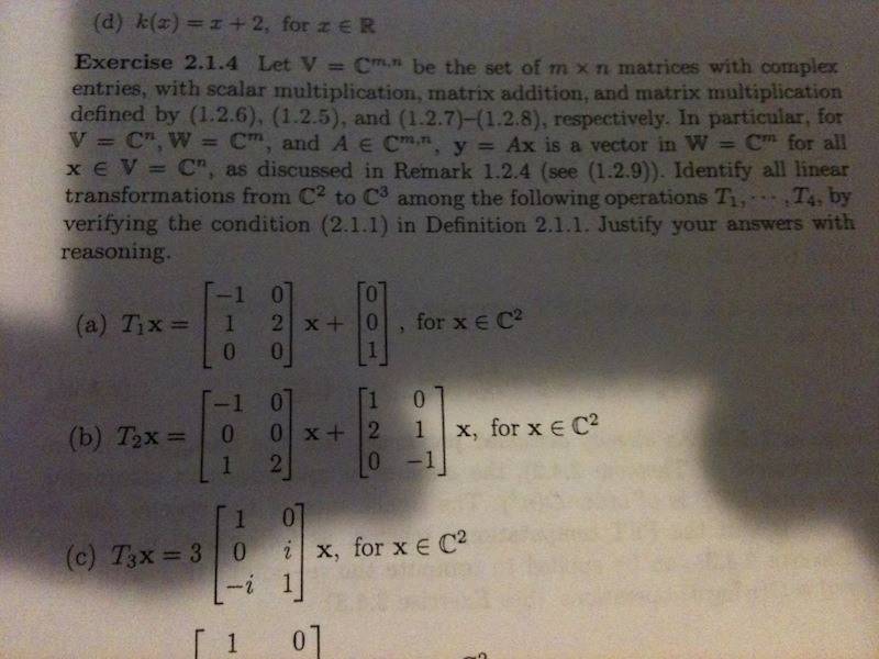

I have a question about part (D), which is
[tex] <br /> Tx =<br /> \left[ {\begin{array}{cc}<br /> 1 & 0 \\<br /> 2-i & 3i \\<br /> i-i & 4\\<br /> \end{array} } \right]x[/tex]
I assume I use the same procedure? Is anything special I need to do in regards to the complex variables?
I find that it IS a linear transformation, is that correct? Also, isn't i-i just 0?
