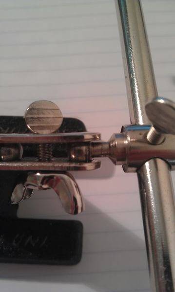

Hi,
Does anyone know what the name of this joint is? And if possible where i could buy a plastic version in Australia or online?
Thanks in advance!
Welcome to PF, Rohan.
I've never seen one like it, but it appears to just be an extremely simplified version of a ball-and-socket. Furthermore, frequent motion seems to be ruled out by the clamping screw, so tolerances aren't critical.
You could make one yourself just by gluing a ball to the end of a rod, then using a countersink drill bit to form the 2 halves of the socket in the bar stock. (I'm thinking that the background of your photo is a sheet of ruled writing paper, which is what I'm going by as a scale reference.)
I've seen this many times over the years, but never seen a "name" for it. Danger is correct in his description.
One finds these things on dial indicator positioning arms. One finds those in machinist's tooling supply houses / catalogs.
Plastic versions? Can't recall if I've ever seen plastic versions. Maybe some type of lab supply or scientific supply source may have something in plastic.
