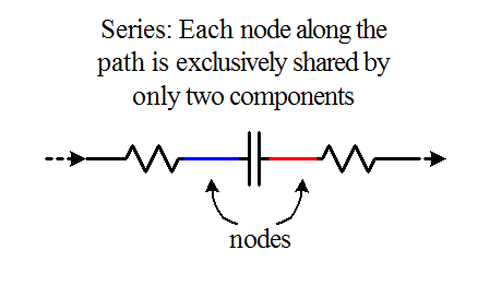

gneill said:Gracy, there is only one series connection in that entire circuit. That is the resistor and battery in the bottom left corner. They share an exclusive connection.
You mean the two connections of yellow node?
If yes that means I understood series connection.

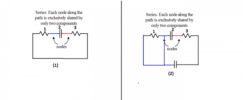

In (1) all 1,2,3 are in series but in (2) only 2 and 3 are in series but 1 and 2 and 1 and 3 are not in series,right?

Sorry!I clicked on post reply reply but was intended to click on upload!gneill said:I don't know what you are referring to. What are (1) and (2) ?

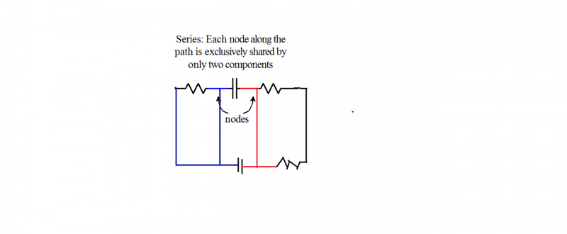

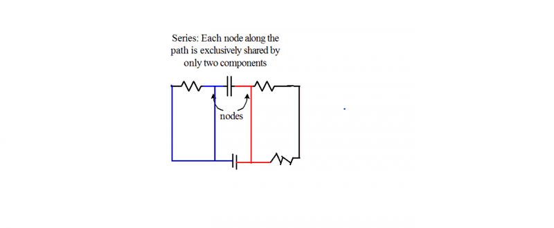

Here no components are in series,Right?
Sorry if my resistor looks odd!
Mentor
- 20,989
- 2,934
In (1) all three components are in series, yes.
In (2) capacitor 2 and resistor 3 are in series, yes, but they are also in series with the capacitor that you've placed at the bottom. Resistor 1 is not in series with anything, in fact it is "shorted out" by the wiring that connects both of its ends.

Two resistors are in series, but they are shorted out (bypassed) by the red path joining their outer ends.gracy said:
Gracy, it should not be necessary to enumerate every possible permutation of connections in order to understand the concept. If there is a single, undivided path for current to follow through a set of components then they are in series. If current has optional paths through other components anywhere along the way then they are not in series.

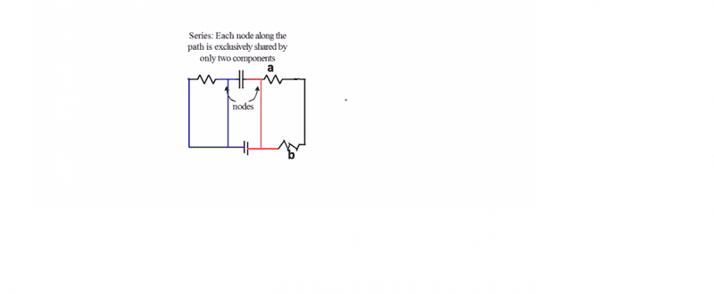

But I can see only onegneill said:Two resistors are in series,
that is

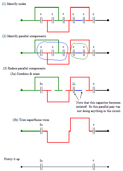

I've explained that a node is isolated, contiguous wiring. If you follow a continuous wire path between two points, then they belong to the same node.On a serious note I want to ask one thing
How do you decide to bring new wire in I mean switching to yellow after blue,I faced this problem while drawing circuits in post #38 and #40.
Each colored "island" in the diagram is contiguous wiring.

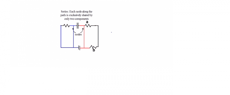

Mentor
- 20,989
- 2,934
a and b are each resistors. That makes two resistors. They are in series.gracy said:

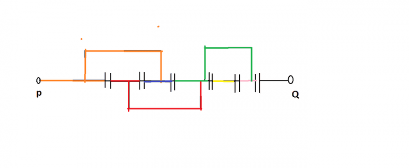

gracy
- 2,486
- 83

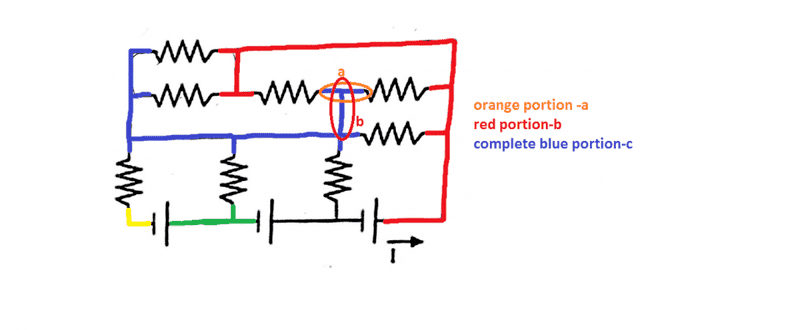

Here node implies highlighted pink portion "A "or complete blue portion(if we refer image in post #17)gneill said:No, any number of components can be in parallel and share the same pair of nodes (only two nodes are required for any number of parallel components).
Mentor
- 20,989
- 2,934
As an example, yes. The blue wire segment is one node. The red wire segment is another node. The highlighted pink portion is just a portion of the blue node, it is not a separate node.gracy said:Here node implies highlighted pink portion "A "or complete blue portion(if we refer image in post #17)
Components that share both of those nodes (red, blue) for their connections are in parallel.

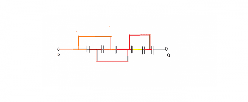

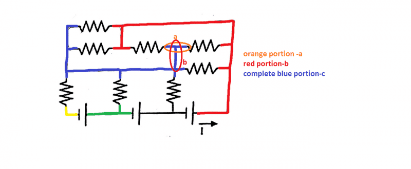

By isolated node (that you used in explanation of series connection)means
orange portion "a" here
it appears like a single line

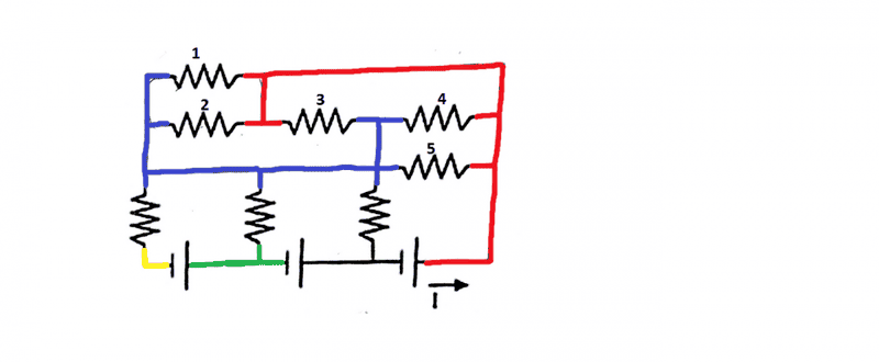

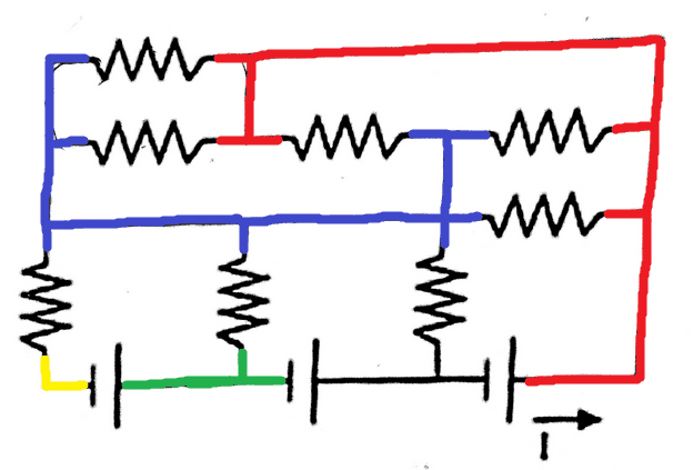

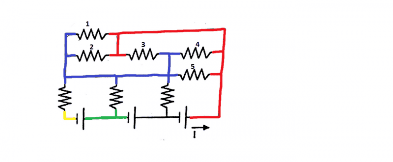

Resistors 1,2,3,4, and 5 are in parallel connection.
gracy
- 2,486
- 83
And there are no other components in parallel connection.
Right?
Right?

Mentor
- 20,989
- 2,934
Correct.gracy said:Resistors 1,2,3,4, and 5 are in parallel connection.
Right?

Mentor
- 20,989
- 2,934
No, it is not isolated. It is a small portion of the larger whole (blue network) which has other connections.gracy said:By isolated node (that you used in explanation of series connection)means

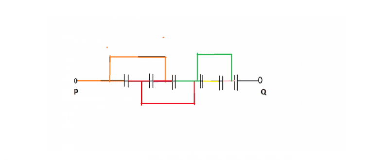

gracy
- 2,486
- 83
gracy said:On a serious note I want to ask one thing
How do you decide to bring new wire in I mean switching to yellow from blue,I faced this problem while drawing circuits in post #38 and #40.
Based on my observation of our diagramgneill said:I've explained that a node is isolated, contiguous wiring. If you follow a continuous wire path between two points, then they belong to the same node.
A node can not cross any component,right?
I mean it will be wrong if I will replace green wire with yellow wire because by doing thatyellow wire will crss the component(battery)
