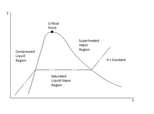

I'm not sure what a T-v diagram is. Can you explain?
Something like this
T-v diagram of a pure substance with T on the vertical axis and v on the horizontal axis, showing a dome with a critical point at its top, a horizontal constant-pressure line across the saturated liquid-vapor region, and labels for the compressed liquid, saturated liquid-vapor, and superheated vapor regions.
Okay. Then if what he said is in reference to a chart like the one above, then it appears that he should have said, "temperature with respect to volume". You may want to ask him for clarification.

When talking about the gas equation PV=nKT you have three variables and can plot anyone against any other. Any of the three can be the independent variable so there are 6 possible graphs. I think it's only by convention that we normally stick to these three...
T-V Diagrams (Y axis = Temperature, X axis = Volume)
P-V Diagrams (Y axis = Pressure, X axis = Volume
Phase Diagrams (Y axis = Pressure, X axis = Temperature)

But if it is a T-v diagram, doesn't it means that v must be the independent variable(x-axis)?
T-V diagrams are usually drawn with T on the y-axis and V on the x axis, however if someone was to do an experiment where T was the independent variable they would probably still plot T on the y-axis because people are more familiar with seeing T-V diagrams that way around. It makes it easier to compare data with other experiments.
