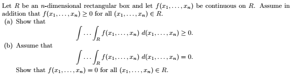

If for n-dimensions f>=0 , prove the integral of f >=0

a) The furthest I have got to understanding the solution is that I need to find a way to show that sup(f(x1,x2,...,xn) >= 0. Intuitively and graphically I can see why the statement is obvious, I'm just having a hard time starting to write the proof...

If ##f(x_1,..x_n) \ge 0## then it's pretty obvious ##sup(f(x_1,..x_n)) \ge 0##. If you don't have a convenient theorem like if ##f \ge g## then ##\int f \ge \int g##, then you might have to use the definition of the integral.
