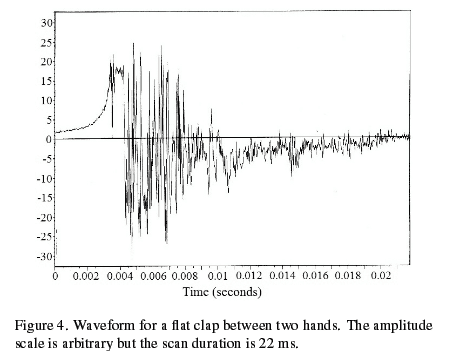

Also look at the sound pressure plots from claps to understand what the propagating waveform looks like...
https://www.acoustics.asn.au/journal/2013/2013_41_2_Fletcher_paper.pdf

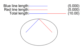

A.T. said:
Yes, thanks. I expect that for the ellipse one would hear 1 pulse first due to the direct transmission from focus 1 to 2 along a horizontal straight line without any reflection, and then a second echo that is much louder due to the constructive interference from all the pulses reflecting off the ellipse?
It sounds like you think of these pulses as packets, like projectiles. If you think of the source and the echo in terms of spreading and interfering wave fronts, does that make it clearer?
Yes.

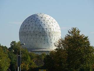

Just for fun. The reflections in an ellipse starting midway between the focus points:
I was once in the center of a radome, like the one below. It's a bizarre experience when you talk, and hear a slightly delayed very loud echo, that also repeats. You should be able to reproduce this with a mic, loudspeakers and some delay in between.
