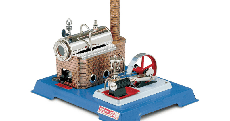

I want to make a clarification:
I have not built, I will not build and I do not recommend anyone to do what they see in the video!!!!!
What we see in the video with good and bad was just to discuss them!!!!!
When I say I want to do something similar, I mean similar, i.e. a steam engine but harmless like in these educational kits:
I'm not advertising, I'm just clarifying what I mean.
With such an educational kit I want to educate myself.
https://www.ministeam.com/products/wilesco-d9
Again, I'm not referring to this exact kit, because I'm not advertising. I mean things like this.
