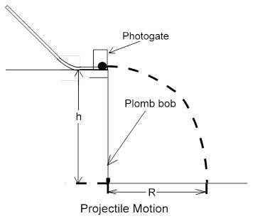

1. What would be the effect on the impact force of a lower or higher release point of a metal ball in an inclined plane.
2. I don't know what to do here.. or how to answer. My teacher told us to include formulas to prove our answers.

Hello po! Thank you for this! we have an experiment, The setup looks like the attach file. The metal elbow track isn't on a table or anything it is hanging on the iron stand with the help of the clamps and all. then as we released the ball, the metal track tilted. We are suppose to explain why it did. (it was tightly connected. PROMISE) I am so sorry. I am not really good in this. >.< But here is the methodology.
Methodology:
1. Set-up your materials as shown on the figure above. Make sure that the elbow track is parallel to the ground and that the photogate detector/sensor is vertically aligned to the edge of the elbow track. Temporarily place the metal ball at the edge of the track and secure the photogate on the iron stand such that the center of the ball and the photogate detector are of the same level. Secure the plumb bob to where the photogate sensor is and make sure that the plumb bob just touches the floor.

Case I: Released from the top-end of the elbow track
6. Measure the vertical distance, h, from the photogate detector to where your plumb bob touches the floor. This is your y for the experiment.
7. Approximate where the metal ball will land on the floor.
8. Position the metal ball at the top-end of the elbow track.
9. Click on the COLLECT button and wait for the toolbar to change to STOP and then, slide the metal ball down the ramp.

The experiment setup makes all the difference ... in plain language, then, would the question want to know how the starting position (up the incline) affects how hard the ball strikes the ground?
The setup suggests that you consider it in terms of change in momentum... (note: Looks like "force of impact" means "impulse", i.e. change in momentum.)
