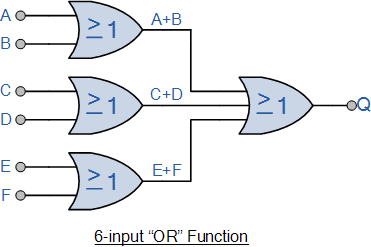

To build a wider OR gate, you just make a tree of 2-input OR gates...
http://www.electronics-tutorials.ws/logic/log11.gif

You need to include the inverters as part of each OR stage. You show the final stage without those inversions...
But I only have NAND gates with 2 inputs. It's a rule from the exercise.
You already show in that drawing how to use a 2-input NAND to make a NOT gate... That's how you got your first 2 NOR gate equivalents...
