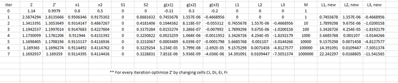

Hi! So I researched more on the topic as I am seriously interested in this, I do hope your patience does not run out on me (lol :DD). I will, however, keep on trying to learn as much as I can.
So I searched more on the barrier methods and I found this paper:
http://www.sce.carleton.ca/faculty/chinneck/po/Chapter18.pdf
In this paper I see that they only used one parameter for ALL the constraints (the three inequalities and the single inequality). It 'did' work for my problem, but I have a few questions. Note that my optimization problem is:
Max Z = x12 + 2x22
ST:
x1 + x2 ≥ 1
x12 + x22 ≤ 1
x1 - x2 = 0.5
I ran the MS Excel Solver and found the optimum point x1 = 0.911438, x2 = 0.411438.
1. I used their method, which involved using an inverse function barrier and a quadratic penalty similar to what you have been telling me, except that they used a single parameter r only. My unconstrained problem is:
Z = x1 + 2x22 - u / (1 - (x12 + x22)) - u / ((x1 + x2) - (1 / √u) * (x1 - x2 - 0.5) 2
It does converge to 0.9110133 and 0.4113009. May I know, what is the implication/disadvantage of using one parameter only? Because it seems so easy to use that I'm terrified I might be doing something wrong again o:).
2. I tried modifying my method and used a logarithmic barrier instead. I strictly followed the (one parameter - literally changed the inverses to logarithms ONLY) but I seem to be unable to get the answer above. My formulation is this:
Z = x1 + 2x22 - u ln(1 - (x12 + x22)) - u ln((x1 + x2) - (1 / √u) * (x1 - x2 - 0.5) 2
It always converges to the point (0, 1) as if the straight line equality constraint isn't even in there. This logarithmic method converges to (0, 1) similar to the inverse barrier where I removed the equality constraint.
If I, however, try to remove the equality constraint from the logarithmic method, it converges to (0.6666, 0.3333) which isn't even an optima. o:)

Hi, I have one last query regarding the the Augmented Lagrangian method. I do not understand the formulation for this one as the first one has no 'max' function and the other inequality has a max function. It's this one:
Ray Vickson said:
$$\max x_1^2+x_2^2 - M_1(x_1+x_2-1)^2 - M_2 (\max(0,x_1^2+x_2^2-1))^2 \\ + \lambda_1(x_1+x_2-1) + \lambda_2 (1-x_1^2-x_2^2).$$
How do I write the unconstrained problem correctly, at least for my problem:
max Z = x1 + 2x22
ST:
x12 + x22 ≤ 1
x1 + x2 ≥ 1
x1 - x2 = 0.5
Is it:
max Z = x12 + 2x22 - M1[x1 + x2 - 1]2 - M2[1 - x12 + x22]2 - M3[x1 + x2 - 0.5]2 + λ1[x1 + x2 - 1] + λ2[1 - x12 - x22]
Then I'm supposed to optimize with respect to x1, x2, λ1 and λ2 while manipulating M1, M2, and M3 in a similar way to the barrier method.

I am trying to make this Augmented Lagrangian work at the bare minimum before I even attempt to go GRG.
So this is my problem. I tried studying this rather simple minimization problem to 'understand' how the ALM works.
min Z = x12
ST: x1 - 1 = 0
Obviously, the answer is x1 = 1. Thanks to you I can make every single barrier or penalty function work and solve the problem - As for the penalty function, I am able to solve it as:
min Z = x12 + M1 ⋅ (x1 - 1)2
where M1 is my penalty parameter.
My problem with this ALM is it does not seem to work, or I am missing something important. My equation is:
min Z = x12 + M1 ⋅ (x1 - 1)2 + λ1(x1 - 1)
If I understand the method correctly, apparently I have to optimize this equation with respect to x1 and λ1 while varying M1.
I seem to be unable to make it work. Assuming I start off with M1 = 1, my x1 is converging to zero while my Lagrange parameter is converging to a massive value approaching infinity if I attempt to minimize it.
If I use a massive value for M1 initially, then it WOULD converge to x1 = 1 but isn't doing the ALM pointless here?
Am I missing something here? Or the method fails in these kinds of problems?
Thanks!
Ah, I found out what's wrong. I don't optimize the lambda parameter, I use an iterative algorithm to update it. Hold on.
You have no idea how teary-eyed and satisfied I am right now. :cry:
At the bare minimum, I believe, I know how to execute the method and I have an idea how the method works, even a little bit. Thank you very much. Now I'm trying to mix the ALM with barrier functions o:) and I'll see what happens. Thank you very much again! :smile:
