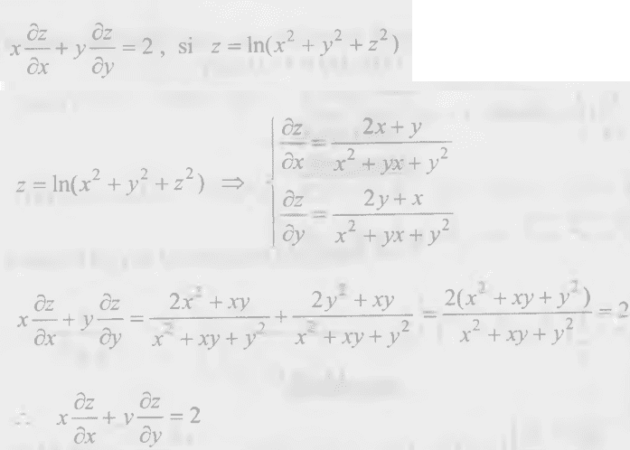

For the given function z to demonstrate the equality:
Handwritten derivation of x dz/dx + y dz/dy = 2 for z = ln(x² + y² + z²): partial derivatives of z with respect to x and y are substituted, then combined into a fraction that simplifies to 2.
[/B]As you see I show the solution provided by the book, but I have some questions on this.
I don't understand how the partial derivative of z respect to x or y has been calculated.
Do you think this is correct?
I think this is a giant errata, I guess the function z is not given implicitly and it simply is:
z = ln ( x ^2 + y^2)
The partial derivatives are calculated normally:
∂z/∂x= 2 * x/(x^2 + y^2)
Similar for y, and with this it is straighforward to demonstrate the equality.
What do you think? There are two options:
1.- Or the statement and solution of the given problem is correct---> In that case I don't understand anything. Could you explain how to get the partial derivatives?
2.- Or there is a giant errata, z is not given implicitly and the calculation is easy.
Worked solution showing that for z = ln(x² + y² + z²), the partial derivatives are ∂z/∂x = (2x + y)/(x² + yx + y²) and ∂z/∂y = (2y + x)/(x² + yx + y²), leading to x∂z/∂x + y∂z/∂y = 2.
[/B]
Is there information missing from the image above, especially in the upper right corner?

This result doesn't match what's given in the solution, so why do you think your guess for ##z## is correct?
The solution is definitely wrong for the given ##z##, but your guess is wrong too. It looks like the solution used ##z = \ln (x^2+xy+y^2)##.

Thanks for your answer.
But with my guess I find:
∂z/∂x= 2x/(x^2 + y^2)
∂z/∂y= 2y/(x^2 + y^2)
So if I substitute in the equation I get:
x * (2x/(x^2 + y^2)) + y * (2y/(x^2 + y^2)) = 2
In the denominator we have the same functions, so we can simply sum the numerators to get:
(2 x^2 + 2 y^2 )/ (x^2 + y^2) = 2
And this equation is true. What am I doing wrong?
No, there is nothing.
