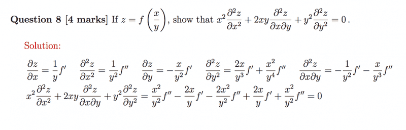

This might seem like a stupid question but I'm unsure what z= ƒ(x/y) means? I'm not sure how I would find ∂z/∂x , ∂z/∂y just from this statement either.

I'm sorry, I'm just really unsure how to apply the chain rule. So is ∂z/∂t = ∂/∂x(x/y) * F' ? But I'm unsure how to find all the other ones. I have the solutions attached to this post but I have no idea how to get them.

What are ##t## and ##F##?
Can you calculate ##\frac{\partial z}{\partial x}## if ##z=f(u(x,y))## where ##u## is a function of ##x## and ##y##?
So i would let u=x/y so then
$$ \frac{\partial z}{\partial x} = \frac{\partial z }{\partial u} \frac{\partial u }{\partial x} = \frac{f'}{y} $$
cause I'm guessing $$\frac{\partial z }{\partial u} = f'$$ or am i completely wrong?
