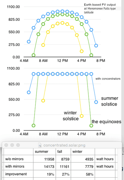

Depending on your latitude, my calculations from last year indicated that "textbook" efficiency increased from between 19%(summer) and 58%(winter) with the inclusion of concentration.
