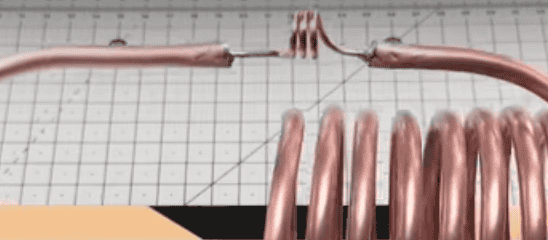

In the video above there is such a system. It can be used both to create cold and to create warm.
In the picture above is the "evaporator", that is, a thin pipe that allows the passage of a small amount of gas.
I think that if I replaced this thin tube evaporator with a turbine, I would recover energy.

Pisica said:
I believe that when expanding the gas at the "evaporator" it is a mechanical thing that is lost that can be recovered.
Why do you think that?
"Yes, but the heat being transferred is latent heat as far as the working fluid is concerned, meaning that the transfer occurs at constant temperature."
Do you mean the latent heat of evaporation and condensation, of changing from gas to liquid and vice versa?
But the heat pump can't work with gas without reaching the liquid state, that is, without changing its state of aggregation?
That's correct. A phase change from gas to liquid occurs in the condenser--that's why it's called a condenser. And a phase change from liquid to gas occurs inside the evaporator--that's why it's called an evaporator.
