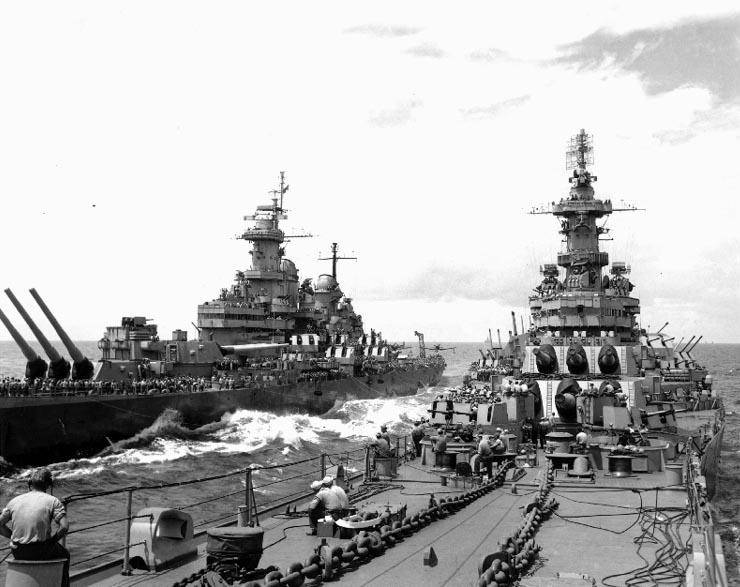

Systems, like artillery, are usually designed to meet multiple performance requirements simultaneously (cost, weight, range, etc.). You can seldom make simple assumptions about optimization of one variable in the design process by only considering a single effect.
Look at this picture of a WW2 battleship and ask yourself "Why aren't the guns all the same type?"

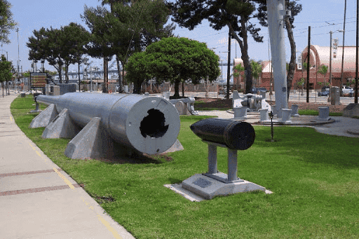

Regarding the picture of a burst gun in post #2. It looks to me like a high explosive shell in the gun detonated prematurely, maybe an instant after the gun propellant was fired. That would explain the position of the damage and the unusual character of the fracture.
The barrels of the biggest naval guns were built up by shrinking progressively larger steel tubes onto the inner liner. By crushing the inner liner, the internal gas pressure could be doubled.

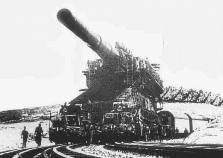

Germany developed big guns during WWI and used the same big guns during WWII and made many improvements. Japan made the largest big gun for battle ships 2500 lb projectile had a range of 30 miles. German battle ships shot 2000 lb projectiles with a range of about 25 miles. Rail guns had a range of 20 to 30 miles. Later in WWII Germany experimented with lighter weight projectiles and reached a range of 75 to 128 miles with rail guns. During WWII Germany developed a big gun barrel 200 ft long but before it could be used the facility was bombed and destroyed.
After the war USA did research with the 200 ft big guns and decided it was not practical it could put a bullet in orbit around Earth and shoot bullets 2500 miles but the gun barrel was stationary and only shot bullets in one direction. The 200 ft long gun barrels were mounting on the side of steep hills to fire projectiles at a certain town 1000+ miles away. Germany put several 200 ft long gun barrels in 45 degree angle tunnels down in the ground it would take a gun crew of about 2000 men to fire and maintain those guns.
Airplanes and cruise missiles make all big guns useless. The 200 ft long gun barrel used about 10 propellant charges they all went off in 1,2,3,4, order very fast to help increase the projectile speed. Modern day artillery has rocket assisted projectiles and GPS guided projectiles that can shoot over mountains turn around 180 degrees and hit objects on the back side of the mountain and shoot right down the entrance hole of a cave. If you want to learn first hand about artillery join the military and sign up for mobile artillery.
