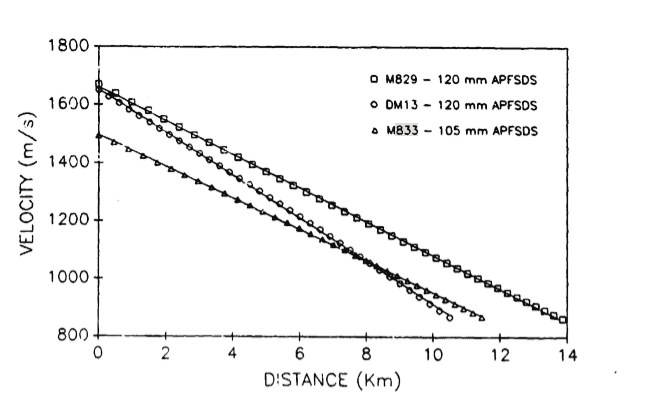

boneh3ad said:
I believe the main gun on an M1A2 Abrams firing M829 APFSDS rounds still only has an effective range of about 3 km. It only about about 20% as much as a standard M795 howitzer shell, though, so it's easier to get up to those speeds but will slow down more quickly due to drag versus a heavier projectile of the same form. It's not apples-to-apples.
I think the main issue with the Abrams APFSDS round is that it is a fundamentally different type of round than the common artillery rounds. The APFSDS round is designed to penetrate armor using its very high speed. So it has to be nearly pinpoint accurate to hit a relatively small target (vs the use of artillery for area suppression) AND has to retain enough velocity to penetrate an armored vehicle. These two requirements are what limit its effective range, though not its maximum range. The table below shows the velocity of several APFSDS rounds vs range:
Line graph of velocity in m/s against distance in km for three APFSDS rounds, showing near-linear decline from about 1500-1650 m/s at 0 km to about 850 m/s near 10-14 km. Legend: M829 120 mm, DM13 120 mm, M833 105 mm.
As you can see, the rounds are all still well above 800m/s even out to 10km+ in range. However, they've lost roughly 3/4 of their kinetic energy by this point, making them far less effective at penetrating their target's armor. Even dropping from 1700 m/s to 1400 m/s is a reduction of about 1/3 kinetic energy and penetrating power, so by the time the round reaches 4 km it is already substantially less effective.
Finally, the very design of any high-velocity sabot-based round is fundamentally at odds with artillery shell design. Artillery shells want maximum destructive power (or maximum utility for things like smoke or illumination rounds) for a given size, which is achieved by packing as much explosive or other material as possible into the shell. A high-velocity round, especially a sabot-based design, typically does the opposite. It reduces the size and weight of the projectile in order to get that increase in velocity and retain it. Great for KE penetrators, not so great for most everything else. Sure you can make the projectile longer, but then you've just increased the mass again, which brings the velocity back down.
APFSDS rounds aren't high velocity because of their sabot design, they are high-velocity because the round and sabot are extremely lightweight. The M1 Abrams 120mm M829 round has a combined sabot and subprojectile mass of 7.1 kg, of which 4.3 kg is the subprojectile itself. Compare this with the M830 HEAT round which has a projectile weight of 13.5 kg, nearly twice that of the M829 sabot+subprojectile, and a muzzle velocity of 1140 m/s. The M829 also uses 8.1 kg of propellant vs 5.5 kg for the M830. Half the weight plus 50% more propellant is required to get the M829 round up to 1670 m/s vs 1140 m/s using the same gun.
Edit: Forgot to add the M830 muzzle velocity. Added now.

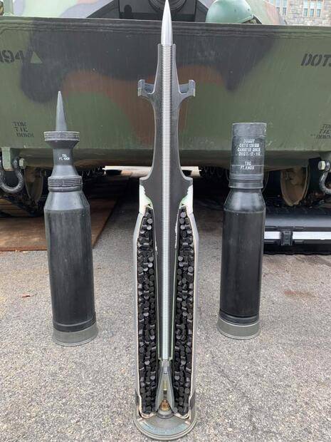

Cutaway artillery shell with a long dart-shaped projectile in the centre, its nose and tail fins exposed, surrounded by packed dark cylindrical sub-munitions in the body; flanking unsectioned shells on either side, all standing on a grey pavement in front of an olive-green military vehicle.
I also think a slim sabot artillery shell with the same weight as a normal artillery shell would get a better ballistic coefficient and that alone would give it a longer range, plus the higher speed because of no losses going to spinn up the projectile. And all of that with a cheaper barrel to make because of no rifling, and probably a longer barrel life too because of the lack of rifling.
Okay. Let's say you have a barrel that's 150 mm inner diameter. What are the dimensions of your sabot shell? How much explosive does it have in it? What is its approximate muzzle velocity? How does it compare to a normal artillery shell of roughly 150 mm?
Let's test this theory:
  • The penetrator for an M829 APFSDS weighs 4.6 kg and is 68.4 cm long and 2.7 cm in diameter, so the aspect ratio is 25.3. It also has 11.9 kg of propellant and casing.
  • The M795 howitzer shell weighs 47 kg, 10.8 kg of which is high explosive.
Let's assume we want the same aspect ratio as the M829 penetrator in the form of a howitzer projectile. TNT has a density of 1.654 g/cm3, so the M795 has 6529.6 cm3 of TNT inside. To mold that into a projectile the same shape as the M829 penetrator (i.e., with the same aspect ratio), it should obey the rule
[tex] L = \left(\frac{4V(AR)^2}{\pi}\right)^{1/3},[/tex]
which results in a shell that is 174.7 cm long. That's already 1/3 the length of the barrel of the M777. Here's the kicker: you can't just shape the explosive like the penetrator because it's the casing that produces the blast frag effect for an artillery round. I don't have number for how much the casing on an M795 weighs, but it's the majority of the remaining weight of the shell since the propellant charges are separate. Let's assume it's 80% of the remaining 36.2 kg, so about 29 kg of high-frag steel casing. That has to surround the high explosive. It has a density of about 7.85 g/cm3, so the volume is 3694.3 cm3. That makes the total volume of the projectile 10,022 cm3, leading to a length of 203.0 cm. with a diameter of 8.0 cm. That's about 40% the length of the M777 barrel.
Now let's assume the ratio of projectile mass to the total mass of the round (including propellant, casing, and sabot) is the same as for the M829. The M829 weighs 20.9 kg, so is about 43% projectile by mass. This means the above shell with a mass of 39.8 kg would be part of a round whose total mass is 92.6 kg.
So your idea is to launch rods that are taller than an average adult male from a round with a mass that is greater than the average adult male. This is a bad idea for several reasons:
  • The round would require de-elevating the howitzer in order to load it, slowing down firing operations.
  • The round would not work with existing howitzers, whose barrels are far too short for this.
  • The round would require considerably more complicated logistical chains to transport it and deliver it to the battlefield (they are twice the mass and almost 3 times the length but with the same diameter as the M795 in this example).
  • The round would require multiple soldiers to lift it and load it into the howitzer, meaning you need more men to man an artillery battery.
  • There still isn't likely to be enough room to ideally shape the charge to produce optimal blast frag without further increasing the size and mass.

I'm a bit late to the party with this, but be careful with those darts as references. That whole system is optimized to give insane single point penetration at close (few km) range, and there is very little thought given for anything above 5km.
Part of that is also the nature of modern armored combat. Beyond that range, the tank sensors and drew may have difficulty picking out their targets on the battlefield, unless you're up on a ridgeline, hull down in a revetment, and your enemy is making a blind charge across open terrain without artillery or air support.
A proper scenario would probably include things like smoke rounds deploying curtains of smoke to obscure visibility, VT/prox fused artillery barrage of known/suspected tank and infantry emplacements, maybe even MLRS salvos deploying shaped charge and anti-personnel submunitions. If your enemy is really capable, they may even be using standoff air launched ordinance to glide silently over your position and deploy sensor fused weapon submunitions on your position to really ruin your day.
If you're having a good day, you can expect to be making engagements with a modern MBT at 3km tops. Usually that's a third of that or less.
As for the idea of subcaliber tube artillery... I can think of a single practical use for it: extremely long-range strike against a fixed, hardened target like a command and control bunker or similar. But it's a very niche role, that depends heavily on being able to pack the requisite GPS guidance into the round, and knowing exactly where the bunker is, and hoping it's shallow enough you can punch into it.
If you want to hit someone with artillery at a great distance, rockets or missiles are absolutely the way to go. Hell, take a page from the US and slap a small GPS-guided glide bomb atop an existing rocket, give it the target, and just yeet that thing as high and far as you can, then glide from there.
Stormer said:
Why are artillery guns still rifled? You would think it would be cheaper to manufacture and it would get higher muzzle velocity and longer ranges with a smooth bore barrel and discarding sabot fin stabilized projectiles like in anti tank guns.
Long range howitzers are smoothbore exactly because rifling converts some of the projectile's energy to rotation. I read this recently but dont remember where. Must be easy to verify though.
