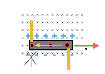

I have a confusing example that I'm studying, I tried to figure out the direction of induced current. But the right hand rule would tell me there isn't, but there has got to be since there is change in flux?!
Here is the example:
The gray bar is the conductor that is moving through a magnetic field with velocity(v marked), the orange wires are connected to circuit outside the diagram, the polarization is what I think the induced EMF is going to be, when using the right hand rule the induced current is pointing up. I'm certain there is induced current, but not sure where it will flow.

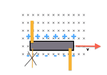

In contrast to this diagram:
It's relatively easy to figure things out.
I don't know what is confusing you. Induced emf is E = (v×B)⋅l .
In first case there's no current flowing in the outside circuit, and in the second case there could be if the circuit is closed.

Assuming the circuit is closed. Why wouldn't current flowing in the first? Due to the induced EMF being across the wire?
I guess it's because of the wires themselves in that diagram(1), wouldn't allow any current flow(if it we're a closed circuit), but if it we're like so:
It would?
PhiowPhi said:
It would?
It could now . Note that in this case vertical length of wire contributes more volts to the properly closed circuit than length of the bar.
True, due to its L > than that of the bar.
However, what if that wire was not inducing any EMF of it's own(being fixed, or not in the magnetic field, etc...) would current still flow from the bar in a closed circuit?
Since the bar has some vertical length , some small emf would be induced in it and some small current would flow to external circuit.

@zoki85 , I'm struggling a bit with the theory.
Going back to the 1st diagram, the reason why current cannot flow(assuming it's a closed circuit), it's because the force on the charge is upward and there is no path for it to move upward? And by attaching those orange wires to the upper/lower surfaces(ignoring their induced EMF's, just focusing on the gray bar's induced EMF) it creates a path for current to flow from high potential to low potential? - Just making sure I got the idea right.Also, is width something to considering at all? I won't because E = -vBL, but... maybe I'm missing something.
I find it useful to imagine myself very small and sitting inside the conductor holding one of the free charges in my hand.
The free charge is an electron but QV cross B is written for positive Q, so we defer to convention...
Like you, in first picture i get Lorentz force on the positive charge is UP
which is same as Hall Effect were there current.
Now close the loop and you get force UP in both the orange wires, again no current flows because of equal and opposing voltages in the orange wires
that is, until your loop starts to exit the magnetic field as it travels right.
Then the induced voltage in right hand orange wire decreases because B out there has dropped to zero,
and as your loop moves right the flux it encloses is decreasing
So both formulas QV cross B and d(phi)/dt both predict a voltage in the loop and current if it's closed.
It is a valid logical tool to reduce things to this preposterous level of simplicity .
When your intuitive reasoning leads you to the same conclusion as the formulas you've memorized you are a whole lot better equipped for exams.
Strive for that 'gut feel' in your equations. Continually rework your mental images until they take you straight to the math. It's easier to figure out equations from good solid basics than to memorize them.

What's interesting though, is the following result when current "starts" to flow, if the conductor is connected to a circuit:
Where those circular things are charges, and the yellow line represent the flow of this charge(i/e flow of current).
Is this correct? Based on where the wires are connected, and that's the only path the right most charge could move, and the middle and the left most charge just has to go up.@zoki85 , thanks for the link, it's a great refresher. But even when I understood the theory, it's a bit confusing applying it so some examples, like this one.
Your new drawing has both yellow end wires oriented so that the force on charges is now upward. A current could flow if the loop is completed outside the magnetic field where its vertical part doesn't induce an opposing voltage..
