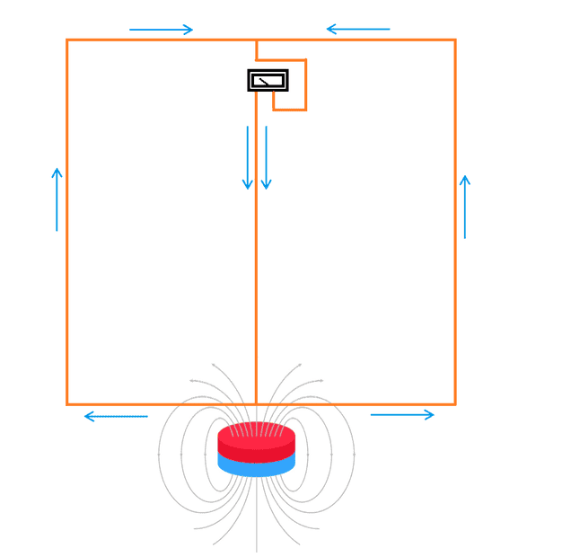

doomer
30
Why there is no current flow in this circuit? (simplified brushless Faraday homopolar generator)
On this diagram, the copper wires are long and extend far beyond the magnetic field range and they rotate with multimeter or BT transmitter, magnet is stationary, the blue arrows symbolize hypothetical currents. I don't understand why emf is zero here. I heard that the middle wire is also cut by the magnetic field lines (because they form loops and must curl) so there is opposite current/voltage induced in the middle wire so everything cancels out, is that true?
The way I see it, the current in the middle wire should be induced perpendicularly to the wire ( - in the middle of the wire and + outside, just like in Faraday disk) so I don't understand how this could block the flow of the other currents coming from the side wires.
Diagram of a rectangular orange wire loop with a central vertical wire and a small meter symbol at top, above a stationary magnet with grey field lines, blue arrows showing hypothetical current directions.
Cylindrical symmetry, if I'm reading your question correctly. The magnetic flux in each loop doesn't depend on the angle. See Faraday's Law. No change in the flux --> no induced voltage.
DaveE said:
Cylindrical symmetry,...
Yes.
The plane containing the conductors is not cut by any magnetic field line.

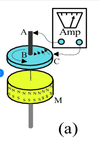

Then why Faraday homopolar generator works? disk rotates and cut the flux lines and voltage is induced in the disk, in FHG flux does not change too.
  • Diagram of a Faraday disk setup: a cyan copper disk labelled C with a rotation arrow, a shaft contact labelled A, a yellow magnet labelled M with alternating N and S poles, and an ammeter labelled Amp connected to the shaft and the disk rim.

doomer said:
It is, just like in faraday disk homopolar generator?
In your diagram, the magnetic field lines that are crossed, or cut, by the wire loop, cross it again to exit, and so reverse the induced voltage, resulting in a sum zero. Where are the two wipers or brushes in your diagram?
The DC voltage produced by a homopolar generator results from the Lorentz force on the electrons, as they move with the conductive rotating disc, across the perpendicular magnetic field.
https://en.wikipedia.org/wiki/Homopolar_generator#Physics
Your loop is on edge, so there is no disc or slip ring, for a brush that is perpendicular to the field.
https://en.wikipedia.org/wiki/Homopolar_generator#Disc-type_generator

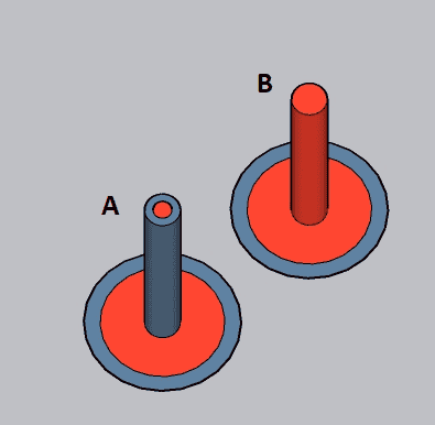

I have a problem visualizing it, it's something like this? which one is correct? A or B? for a Faraday charged disk with metal shaft or center/radial wire.
  • Two 3D renderings of a disk with a central shaft, labelled A and B: a blue-grey rim with a red disk face, and in A the shaft is a dark tube with a small red tip, in B the shaft is solid red.
Baluncore said:
If they are in series, the current must be the same.
You ask why no EMF is induced, but it is induced, once forwards in the disc, then again equally backwards, in the wire permanently attached to the rotating disc, which moves at the same speed, through the same field.
The cancellation is of the induced voltages, voltage that was needed to drive a current.

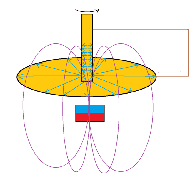

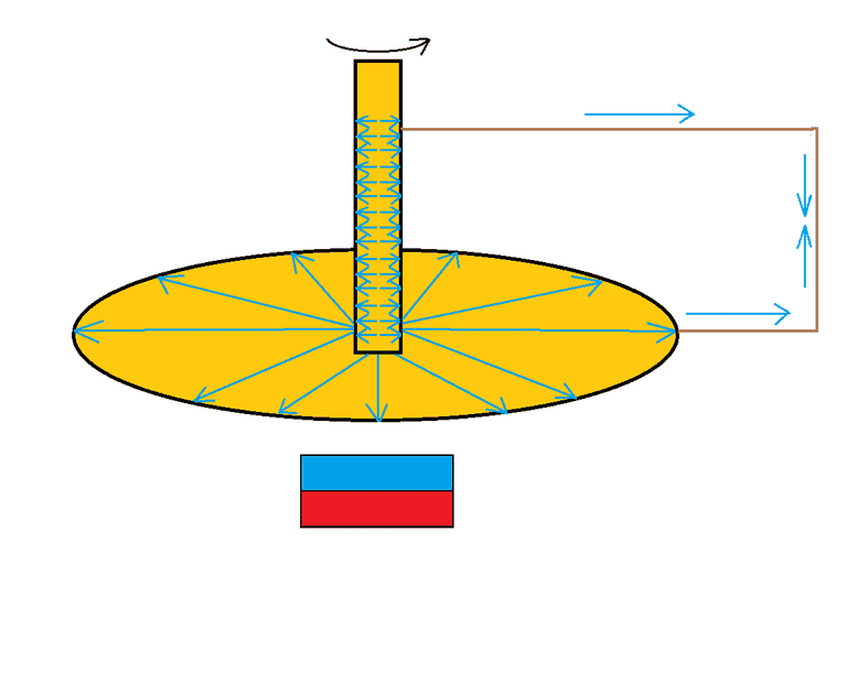

I think i get it now, this is the correct picture and vectors?
  • Diagram of a homopolar generator: a yellow metal disc on a vertical shaft rotating clockwise, with blue radial arrows showing electron flow from the centre to the rim, a brown wire loop connecting the shaft and the rim, and a blue-and-red bar magnet below the disc.
Me too. I have no idea what those pictures mean.

If you don't have a sliding contact, then the rotation will produce a multiturn coil of wire with magnetic flux running through it. The number of turns effectively increases with ##\theta / 2\pi## as one increases theta. It comes from the topology of winding a rope (or wire ) loop onto a cylinder....you get a "winding number" from the process. Because there are no magnatic monopoles all magnetic lines of force are closed curves and the flux through stacked turns must include the number of turns.in the coil because somewhere you must cut that closed field line to add another turn unless you cut the wire with a clever contact.

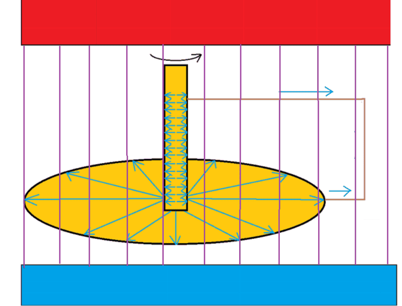

Maybe this is closer. There are no voltages induced vertically. The magnetic core connects the poles outside the picture.
This is showing how it will not work, because there are no brushes and the wires rotate with the disc. If it had brushes, there would be no voltage induced in the horizontal wires.
Diagram of a Faraday disc: a yellow disc with a central yellow shaft lies between a red top pole and a blue bottom pole, with vertical purple field lines, blue radial arrows on the disc, and a brown wire loop running from the shaft to the disc's edge.
Wait, the purple lines are magnetic field lines right? BUT my idea was to put wires away from the magnetic flux lines, to avoid any problems that could arise from magnetic flux lines cutting wires. I'm talking about a scenario in which magnetic field does not reach wires, magnet is under the disc and magnetism reaches the disc and half of the shaft (or middle wire) and nothing else (magnet is small).
That is impossible if they are attached to, and rotate with, the disc.
If that was the case, then why did you draw the light blue arrows on the wires.
If the magnet is small and below the disc, the field will pass through the disc twice, cancelling the induced voltage.
I want to rotate disc with wires,only one magnet under the disc.
the blue arrows on the wires just symbolize canceling forces but I dont know if I understand the canceling vectors correctly, please, can you draw the canceling forces/ voltages for:

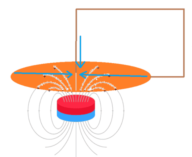

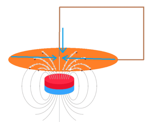

You need top stop and think, why are you doing this.
Where the local bar magnet field cuts the disc, it usually goes back through again, cancelling the voltage. That wastes disc area twice.
Diagram of a bar magnet beneath an orange disc with a brown rectangular circuit wire; field lines loop out of the magnet's north pole and blue arrows show the disc moving sideways.
I'm sorry but I not seeing the canceling... magnet is under the disc and in the middle of the disc and - is at the center of the disc ( - is also in the center wire) + is at the edge of the disc, polarity does not change, induced voltage/ force is radial and in one direction? ( outward or inward, depends on rotation direction or magnet polarity) the edge wire rotate but aint being cut. I know that you are right but i just can't see it, need two pictures with two pases of the disc with vectors or so something... the brushes somehow stop this canceling but the disc rotates in the brushed version in the same way...
