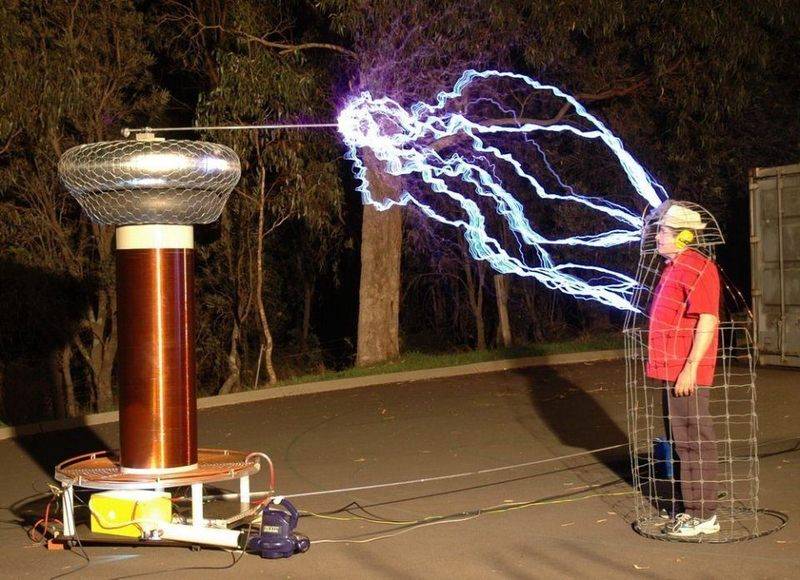

A Faraday cage does not suppress electromagnetic fields inside it - it just shields from external fields.
Therefore any electricity/electromagnetism experiment inside a Faraday cage should proceed normally... the chamber walls you describe would be the boundary conditions for the Maxwel equations ... look up "wave guide".
Note the bolded section of what Simon said ... that is your answer
if there is an internal field, it won't get out ... aka a microwave oven
if there is an external field it won't get in eg ...
