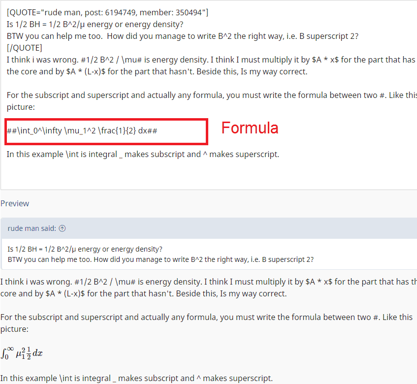

I think i was wrong. ##\frac{1}{2} \frac{B^2}{ \mu}## is energy density. I think I must multiply it by ##A * x## for the part that has the core and by ##A * (L-x)## for the part that hasn't. Beside this, Is my way correct.
For the subscript and superscript and actually any formula, you must write the formula between two #. Like this picture:
##\int_0^\infty \mu_1^2 \frac{1}{2} dx##
##\int_0^\infty \mu_1^2 \frac{1}{2} dx##View attachment 245286
Right! You're there!
I'm familiar (sort of) with LaTex so OK now I know. Before the latest console revision you could write subscripts and superscripts without resorting to LaTex. Thx.
