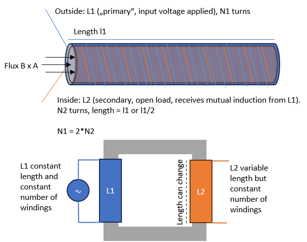

Hello!
I have a question regarding the mutual inductance of two coils in a transformer.
In the formulas for linked coils ##M=k*\sqrt{(L_1*L_2)}## where ##k=1## for a perfect coupling.
I wanted to check my understanding about mutual inductance and see how it can be determined. When I vary the secondary coil length I'm getting into trouble.
My approach:
To determine the mutual inductance, I found many examples where one coil ##L_2## of length ##l_2## with ##N_2## windings (I refer to it as output) is surrounded by a coil ##L_1## of length ##l_1## with ##N_1## windings (input). The radius is ##r##.
With the assumption that length ##l_1>=l_2## and ##l >>r## the simplification is done that the flux from ##L_1## will be nearly constant inside the solenoid and pass completely through ##L_2##. The surface area entering the coils should be ##A## and is equal (they have basically the same radius). This example seems to be similar to a transformer (flux created by a current flowing through ##L_1## is guided completely through ##L_2## and will induce a voltage here). No current flow in ##L_2##, open load.
Can I use this approach here? For better understand I put a sketch below.
Because of ##l>>r## the flux generated inside ##L_1## is ##μ*N_1*I_1/l_1##. As it passes through ##L_2## completely it causes the mutual induction ##M_{21}=μ*N_2*N_1*A*/l_1##. This is valid for any length ##l_2## as long as it is shorter than ##l_1##.
##L_1## and ##L_2## have same length:
In case ##l=l_1=l_2##, the inductance values are: ##L_1=μ*N_1^2*A/l## and## L_2=μ*N_2^2*A/l.## I see that ##M_{21}=\sqrt{(L_1*L_2)}##, same as in the transformer formula, good.
If ##N_1=2*N_2## then ##L_1=4*L_2##, that matches a regular 2:1 transformer operation:
The input voltage will cause a magnetizing current (input divided by impedance of ##L_1##), which will cause the self inductance of ##L_1## with the same voltage opposed to the input. The induced output at ##L_2## will be half of the input voltage (As ##N_2*N_1## from ##M_{21}## divided by ##N_1^2## from ##L_1## substituted = ##0.5*N_1^2/N_1^2 = 0.5## and I know ##L_1## counteracted the input voltage). The output is open so no current can flow in ##L_2##.
Or in shorter words: ##M_{21}## is ##0.5*L_1## and both see the same flux.
##L_2## made shorter (my problem starts here):
Now, lets assume the coil ##L_2## is made shorter, but still keeps the same amount of windings as before. It is now basically the input coil ##L_1## cut in half, so it only has the length ##l_2=l_1/2##. If the windings are kept the same and the length is now halved, the inductance has doubled (same ##N_2## but half length).
As ##L_2## is still completely within ##L_1## (even more now with the half length), the flux it sees from ##L_1## is still the same (entry/exit fringes neglected), and it passes through the same amount of windings. ##M_{21}=μ*N_2*N_1*A*/l_1## - no change to the equation above, same flux and same number of windings. Now ##L_1=2*L_2## instead of ##4*L_2## as the ##N_2/l_2## part of the ##L_2## inductance has changed.
But, according to the formula, the mutual inductance will stay the same.
This means: The input voltage at ##L_1## will still create the same magnetizing current and self inductance as before (no change here). As the mutual inductance stays the same, also the same voltage should be induced at ##L_2## (same number of windings as before).
Now here I have a discrepancy.
##L_1## has stayed the same, it will have the same magnetizing current and according to my understanding create the same flux in the circuit. The inductance of ##L_2## has changed but not its windings.
Now with ##l_2=l_1/2## there is a discrepancy: ##M_{21} != \sqrt{(L1*L2)}##
##\sqrt{(L_1*L_2)} = \frac{μ*N_1*N_2*A} {0.707*l_1}##
Now because of the changed length the output is ##\sqrt{2}## higher, which does not match my own derivation where the mutual inductance stayed the same.
If I simulate in Spice and link two coils ##L_1## and ##L_2## where ##L_1=2*L_2## with ##k=1##, without load for ##1V## input I get ##0.707V## output, which matches the equation ##M=\sqrt{(L_1*L_2)}##. When following the scheme described above it should be ##0.5V## only.
Where is the mistake?
Summarized: The flux created at ##L_1## is always the same and should pass completely through ##L_2## so I expect it will always see the same flux. If the number of windings in ##L_2## stays the same according to my derivation above the induced output voltage should be the same. But as the inductane of ##L_2## is different the voltage is different, matching ##\sqrt{(L_1*L_2)}##. If the voltage induced is number of windings multiplied with the flux change ##e=N*\frac{dΦ}{dt}##, and neither windings nor flux have changed at ##L_2##, why is the induced voltage seen different?
Some help to clear this up would be appreciated a lot!

Possibly, I'm not sure. Thanks for reading and trying to understand the long post!
I'll try to boil it down to a more simple example:
Two coils are wound on the same core. Now both have the exact same amount of windings but different length. For this exercise I will assume no leakage because of the core.
In air, the inductance of the primary is lower (windings more spaced), inductance of the secondary is higher (windings more close).
My expectation is that even with the core enhancing the inductance the primary would still have a lower inductance.
This creates the discrepancy:
If I apply an input voltage on coil 1 (load on coil 2 open) there will be a magnetizing current and flux. So I have a ratio ##Φ_1/i_1##. If I apply the same voltage on coil 2 (load on coil 1 open) there will be a lower current (as the inductance is higher) and a ratio ##Φ_2/i_2##. But the ratios are different, coil 2 with the high inductance will create more flux per current (e.g. half length means double inductance, means half current but divided by half length the same flux).
And as the flux of one coil - because of the core - is completely guided through the other coil, this would mean that a current ##i## from coil 1 would cause a voltage in coil 2 but the same current in coil 2 would create a different flux and therefore voltage in coil 1. Meaning the mutual inductance ##M_{12}## and ##M_{21}## would be different. But that can't be true.
I hope this was understandable, sorry for the lengthy explanation.
You are assuming the core gives 100% coupling. The inductance is then proportional to the square of the number of turns, independent of the coil area or the length of the winding over the core.
The area and the length of the winding term, A/l, change the solenoid inductance only when the magnetic core is absent, and assumed to be replaced with non-magnetic air.
Ah! That matches with what berkeman was suspecting. Thanks for identifying and clarifying my mistake here.
It was a little bit confusing because even some webpages used examples like that (coil in coil with air core) to explain transformer-like behaviour and the mutual inductance. And I was not sure if I could apply it, but thought it would be possible as one coil completely covered the second one, so I tried to transfer it (and for the "normal" case it even worked).
So my understanding is that both coils now appear with the same inductance which is dependend now almost only on the number of windings, and the geometric difference does not matter as the flux is guided by the core. If that is correct I really learned something today which kept me busy some time.

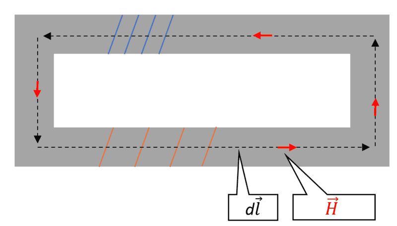

axim said:
This comes from the Maxwell equation relating a current through a conductor to a magnetic field ∮H⋅dl. Which for my understanding is the current integrated along the wire, giving the resulting H .
The integral here ## \oint H \cdot dl =NI ## is not integrated along the wire. Instead, it is integrated through/around the inside of the core. The current is that which passes through the plane of the disc whose boundary is the loop through the core. (Note also that this includes currents in the secondary coil, and how the primary will then supply additional current to offset the current in the secondary, keeping ## H ## and thereby ## B ## the same, with ## |N_p I_p|=|N_s I_s | ##, and the ## N_p I_{po} ## thereby determining the ## H ## and ## B ##).
Note: This is different from the integral that is done to compute the voltage of one of the coils, where the ## V= \int E_c \cdot dl ## does go along the wire of the coil.
I created a small drawing after a short clarification (thanks to Charles!).
Maybe it will help someone who will find this later.
##\vec H## and ##d \vec l## always point in the same direction so that ##\oint H \cdot dl## will simplify to just ##HL## with ##L## being the torus length.
