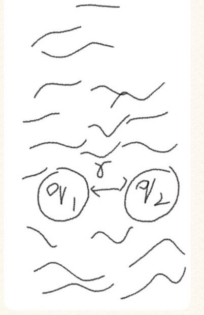

Following the above statement my teacher was trying to prove something and it started with suppose q1 and q2 are charges placed in a medium (k) of infinite expanse. The distance between them being r. He took q1 and q2 to be some spherical particles and not point charges and concluded that
Net force on q1= Force due to q2 + force due to Induced charges in q2 + force due to induced charges in q1.
Firstly I dont understand why Induced charges will have a different force (?) I dont even understand induction mathematically I think.
Secondly If I pretend that I understand it , the force due to Induced charges in q2 is said to be -q2 (1-1/k) but shouldn't it be -q1(1-1/k)??? Since the other charge is responsible for creating the induction.....

Should I attach the whole proof?
haruspex said:
That would be most helpful.

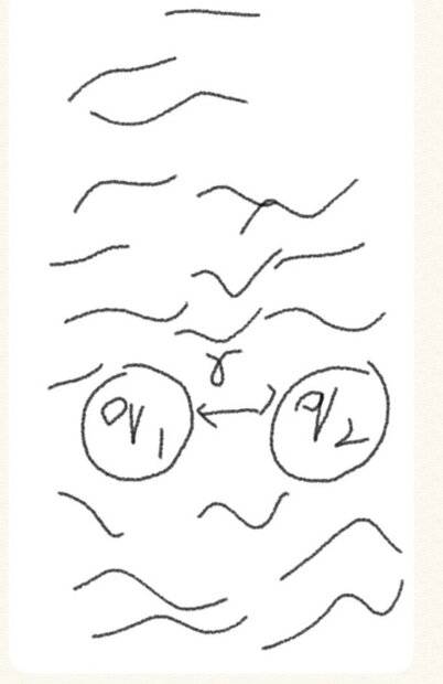

Note (In a medium)
Suppose q1 and q2 are placed in a medium(k) of infinite expanse
Hand-drawn sketch of two charges q1 and q2 inside a wavy-lined medium, with a double-headed arrow between them labelled with a gamma-like symbol and a single-headed arrow pointing from q2 toward q1.
Net force on q1, ## \vec F ## = Force due to q2+ Force due to induced negative charge around q1+ Force due to induced negative charge around q2
Force due to induced negative charge around q1 =0 as its uniformly distributed
$$ \vec F= \frac {q1×q2} {4πE_0 r²} + \frac {q1 [ -q2[1-\frac{1} {k}]} {4πE_0r²} $$
$$ \frac {q1 q2 } { 4πkE_0r²}$$

tellmesomething said:
Note (In a medium)
Suppose q1 and q2 are placed in a medium(k) of infinite expanseView attachment 344358
Looks to me to be the same logic as in https://www.physicsforums.com/threads/derivation-of-induced-charge-on-a-dielectric.846504, but run in the opposite direction.
