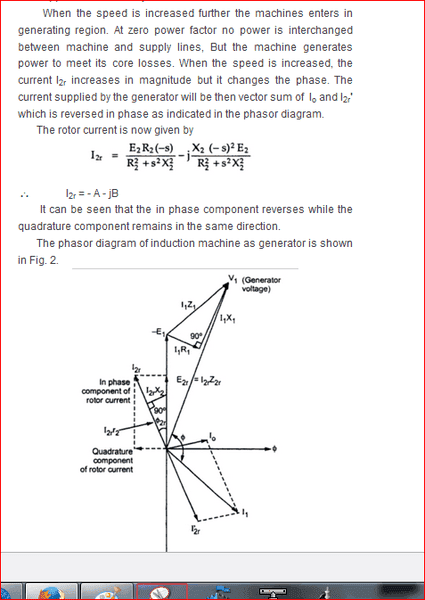

How about we apply some real overly-simple thinking ?
Well, at synchronous speed there's no rotor current hence no rotor flux
so let's simplify the machine down to a lossless one , no friction or windage and lossless iron that's infinitely permeable .
Stator supplies magnetizing current required to push flux across the air gap
and that magnetizing current is pure reactive (no watts) meaning it's 90 degrees out of phase with line voltage.
just below synchronous, rotor current flows , causing stator current to acquire a real component that delivers the watts mechanically removed by the shaft
just above synchronous, rotor current flows . causing stator current to acquire a real component that removes the watts mechanically delivered by the shaft
and those real components of stator current being small and perpendicular to the large imaginary component
do not affect the hypotenuse very much at all.
Meaning stator current (hence stator MMF and flux) does not change very much at all.
It just swings slightly away from 90 degrees behind applied voltage.
Now
since it's a vector addition at ~90 degrees
is perhaps a mistake to say rotor flux "adds" or "subtracts" to stator flux? Because that infers direct not quadrature addition?
That's more of a question than an answer... because I'm not sure whether this line of thinking really leads to better understanding.
Seems to me since it's symmetric about zero torque, and stator current increases for either motor or generator operation,
if you say that one case cancels then so must the other.
I wish i'd taught a motors course somewhere along the way so i'd have a better answer for you.
What's your thought ? Is my logic true ? Corrections are welcome.
Can you use this as a launch point for better thinking ? When we can draw a simple phasor diagram we are getting there.
It'll take me quite a while to absorb this guy's attempt
http://yourelectrichome.blogspot.com/2011/08/induction-generator.html
