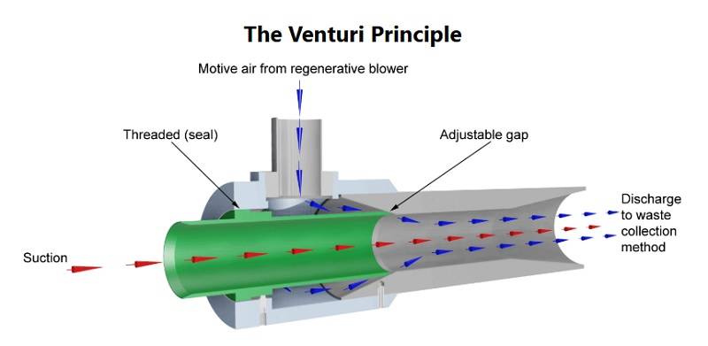

Yes. Start by searching pneumatic conveyor. That will lead to sites showing systems with a suction blower connected to a cyclone separator as mentioned by @Baluncore. Spend some time studying the differences between lean phase, dilute phase, medium phase, and dense phase systems. Here's a good link to start: https://www.pneumaticconveyingsolut...xMxDJOlAV9OzEB52oB17FWyH1rrd9F5Bb-fH6lNu1SacS. There are many others.
There are also systems that use a pressure blower and a venturi. Use search term trim conveyor to find these. These conveyors are typically used to remove paper edge trim at high speeds, but would work in your application. A link (not the only link) for these systems: https://www.converteraccessory.com/products/foxtrim/fox.php#principal. These systems do not need a cyclone. Image of a venturi from the above link:
These systems are very powerful. When turned up too high, they will shred a 2" wide strip of heavy coated paper (as heavy as all of those political ads that infested US mailboxes recently) into inch long pieces.
These are all mature technology. You just need to find a supplier that understands your needs.

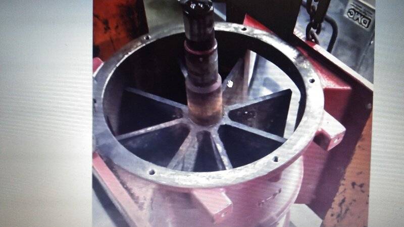

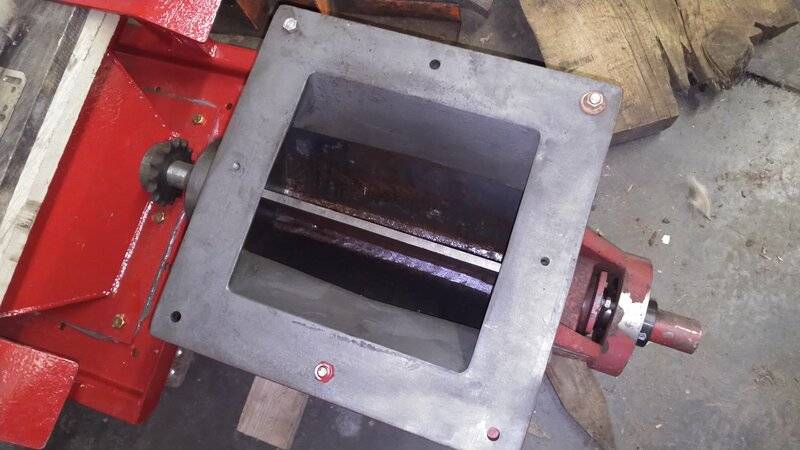

Here is a rotary airlock I have in my shop right now. I believe it was in a flood. Seized up. Pressed the rotor out and gave the outside a bath in molasses to take the rust off. Cleaned everything up and put new bearings and seals in. Very little use apparently. Seems to be little wear. Could not remove any shims from the ends. Here it sits. I'll dig for a few pix of it disassembled also.

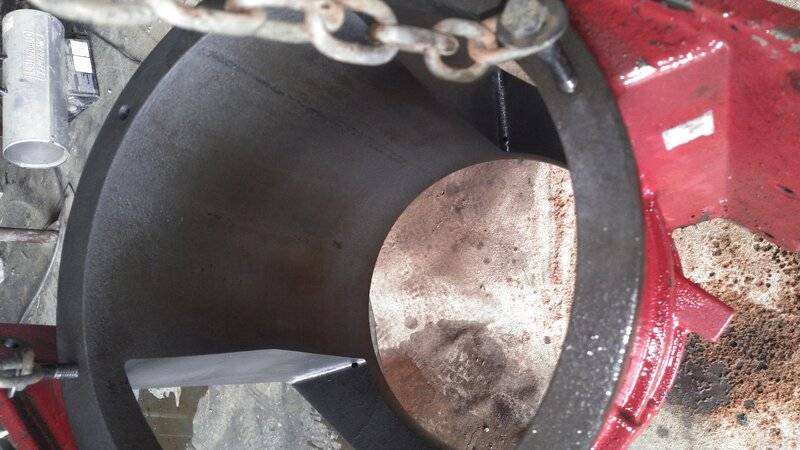

Here's a few pix of the barrel after a soak in molasses, rinsed, dried and oiled.

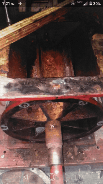

Once I got it to move in the press I took it back out and laid it horizontal and fashioned a puller to get it the rest of the way. The rotor won't go all the way through the table on the press. Some of these pic are poor quality. I needed to show someone else these and they were no longer on my phone. I simply shot the screen of the notebook computer they are on.
Here it is rusted up.
