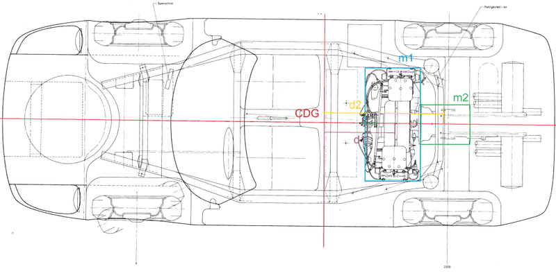

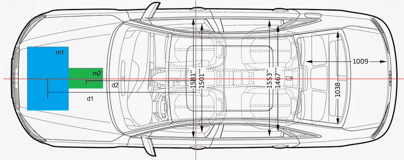

I understand what is moment of inertia is, flywheel with more mass at the edge has more inertia than flywheel that has mass closer to center.
quote from link:https://decarreteres.wordpress.com/2019/04/24/chassis-engineering-polar-moment-of-inertia/
We will only consider the engine and gearbox as poles of inertia, since they are the elements that have the greatest influence on a vehicle. In a real calculation all the elements of the car should be taken into account.
The lengths are calculated from the vehicle’s center of gravity, to the center of gravity of each of the elements.
Let’s assume that the Porsche 904 engine in the example has a total mass of 100kg and its gearbox weighs 50kg. Also assuming that the center of gravity of the engine is 0.4m away from the center of gravity of the car, and that the gearbox is 0.8m.
904
The calculation result for the Porsche 904 will be:
ΣM = m1*d1² + … + mn*dn² = 100kg *(0’4m)²+50kg*(0’8m)²= 48kgm²Let’s see now what the same calculation shows in the case of a car with it’s weights far away from the center of gravity, such as an Audi, with it’s engine ahead of the front axle.
A8
Assuming the approximate values are 100kg for the engine mass (the real one would be closer or more than 200kg), 50kg for the gearbox; The engine’s cog is at a distance of 1.5m from the center of gravity and the cog of the gearbox at 0.8m.
ΣM = m1*d1² + … + mn*dn² = 200kg *(1’5m)²+50kg*(0’8m)²= 482kgm²
After this calculation we can see that the polar moment of inertia is 10 times higher in this case, due solely to the position of the engine since the rest of the values are identical in both examples.
This means that we will need to apply 10 times more power to move the engine and gearbox in the Audi than in the Porsche. No other than the tires have the ability to do that, therefore they are suffering 10 times more load.
For this reason the vast majority of racing cars have mid engines and try to ensure that all the masses are as close as possible to the center of gravity, having as a result a very agile vehicle, even though it also means abrupt reactions.
The location of the poles of inertia influences not only the car’s nimbleness, but also the type of reactions it will have. A car will understeer if its masses are mostly in the front and will oversteer otherwise."
Why they assume that car rotate around c.g. just like seasaw rotate around fixed pivot point?
I think their pivot point is not ok..
So how to find moment of inertia for car in turn?

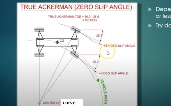

But you cant take axis what ever you want..?
Car front wheels turn so that mean, he "pivot" somewhere near rear axle.
If they want low moment of inertia than car "pivot" must be at c.g. that would be ideal.

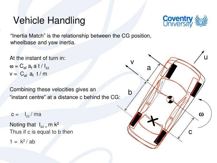

When the car goes around a curve, the motion can be seen as a linear acceleration of the center of mass and an angular acceleration around the COM. Both accelerations are due to the external forces which are applied at the wheels.
The angular acceleartion is given by ##\alpha=\frac{\tau}{I}## where ##\tau## is the torque and I is the moment of inertia. Considerind the simple model from your link, with two mases attached to a rod, if the forces are applied at the positions of the masses (these may be the wheels) the torque is proportional to the distance from the point of application and the axis (here the center). But the moment of inertia is proportional to the square of the same distance. So, if you move the masses closer to the center you decrease both the torque and the moment of inertia but the moment of inertia decreases faster and you need less force for the same acceleration. Or larger acceleration for same force, which means it turns faster in the right position. for the car is more like having this model with an extra mass along the rod. In this case the effect is even stronger because the torque does not change (forces are still applied at the wheels) but the moment of inertia decreases.
Note that this analysis does not assume that the COM is the instantaneous center of rotation at any time during the motion. It is not necessary to be so.
Also, note that I have no idea about automotive design. They may have other reasons for placing the engine where they do.

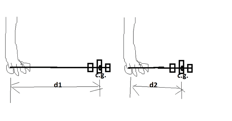

In both case masses are equal distance to c.g., but left case is harder to rotate because lever arm is longer..
So distance from c.g. to center of rotation(arm) is what affects polar moment of inertia.
I dont understand why they use c.g as pivot point?
Every object has axis where moment of inertia is smallest, so you cant choose axis what ever you want
Racket has smallest inerita at axis e1

What are you trying to represent with your diagram?
That different axis get different moment of inertia..
I dont understand concept that you can choose whatever axis you want when anylize moment of inertia..
That is correct.
But, in your post #9:
1) What are those things on the right end of the represented lever?
2) Is that hand moving?
3) Who are “they”?

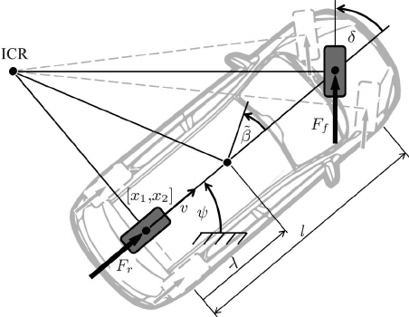

It rotates around any axis you pick. This is the point you seem to miss. There are some special axes, like the one passing through the COM and the one through the instantaneous axs of rotation, which have special properties.
But there is no axis around which the car does not rotate, if it rotates at all.
I am not sure what you mean by pivot axis. Maybe the instantaneous center? This is the point which is instanatenously at rest. It may be at one of the wheels, I don't know. But no matter where this is located, it also rotates around the COM, no matter where this is located. And this is the reference of choice for the study og the dynamics.

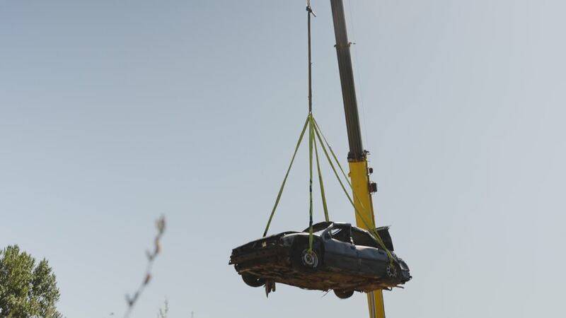

1) Why 3 masses?
2) But that situation is very different from the one in your original post. In real life we don't have a hand moving the car, the car is self-propelled.
3) Comparing resistance to forced rotation (about the center of mass) between both cars in the original post:
Imagine that you have a crane and sling to lift each car off the ground.
A vertical line from the hook will cross the center of mass.
You grab the nose of the Porsche and I grab the tail.
We walk in opposite directions, trying to turn the car around the hook, faster and faster (accelerated horizontal rotation).
Then, we do the same with the Audi.
Questions:
Which car offers more resistance to us?
Which car reaches a full yaw rotation quicker (while you and I are applying similar force to nose and tail of both?
This is case where axis of rotation("vertical axis") pass through car c.g. , harder to turn will be car that has masses further away from that axis.
Porsche has heavy engine at tail, if axis of rotation is at nose then he has big moment of inertia but if axis of rotation is at rear axle that he has very little moment of inertia because engine is close to that axis.
So my conclusion is that c.g. must as close as possible to axis of rotation, and we cant find moment of inertia if we dont know where that axis is..

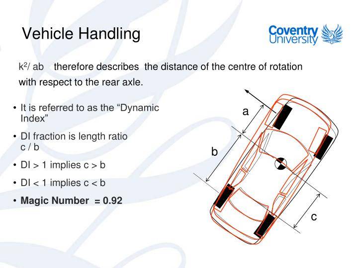

suorce: https://www.slideserve.com/zalman/lecture-7-full-vehicle-modelling
What is this center of picture below?
Pure accelerated rotation analysis should be done using cg as reference, just like it naturally happens with our crane.
You are correct, the car with heavier parts located far away from cg-axis of rotation will be much harder to rotate from repose and to stop from rotation (note that in both cases acceleration and inertia are involved).
In you diagram with the hand, we have translation of the cars, happening simultaneously with the pure rotation, which makes our analysis of moment of inertia more confusing.
Pure rotation with no translation:
Nose of car points North-you close your eyes-nose of car is pointing West when you open your eyes.
The cg has rotated over itself, but it has not moved in any direction.
Pure rotation with simultaneous translation:
The cg has rotated over itself, like every other part of the car, and simultaneously the cg has moved describing a circular trajectory (one quarter of a circle).
In both cases, the resistance to accelerated rotation or angular inertia of the car has been exactly the same (for equal angular acceleration or ##rad/s^2##).
user079622 said:
Some symbols are not defined in that picture but from the form of the relationship for "c" this seems to be the location of what is called "center of percution" for oscillating systems. Maybe here it will be called "center of rotation" but it is not the instantaneous center of rotation. The car seems to be rotating so that the front left wheel is the instantaneous center of rotation (possibly you will call it "pivot"). This point is at rest, its translation and rotation velocities cancel one another.
For a physical pendulum, the significance of the center of percution is that you can replace the physical pendulum with a small ball with the same mass attached to a string with the length equal to the distance between the pivot and the center of percution.
I don't know what is the importance of it for the car motion. Maybe you should reasearch this.
