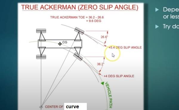

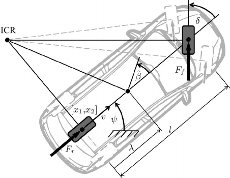

The car seems to be rotating so that the front left wheel is the instantaneous center of rotation (possibly you will call it "pivot"). This point is at rest, its translation and rotation velocities cancel one another.
Dont understand your view.
Center of curve is ICR not front left wheel.
Car ICR depend on acerman geometry, but that center is irrelevant for polar moment of inertia
Nonholonomic-car-model-with-longitudinal-wheel-forces-and-instantaneous-center-of.png

If car turn front wheels 90degress to the left, and c.g. of car is in the middle, isnt obvious that axis of rotation is not pass through c.g.?
I just want to tell to find car moment of inertia we must first find out how far is axis of rotation from c.g, I bet that distance is never zero..

I did not say center of curve, did I?
Instantaneous center of rotation moves as the car moves. It's fixed just for an instant.
Do you realize that what happens here can be analized as the motion of the COM around a curved path as well as a rotation of the body around the COM? If the path of the COM is part of a circle, there is a fixed center of that path.
For the rotation around the COM, there is always an instantaneous center of rotation which is at rest at that instant. This is not the center of the curve described by the COM and may have different position on the body or outside the body, at different instants. These are basic concepts in the mechanics of rotation for rigid bodies.

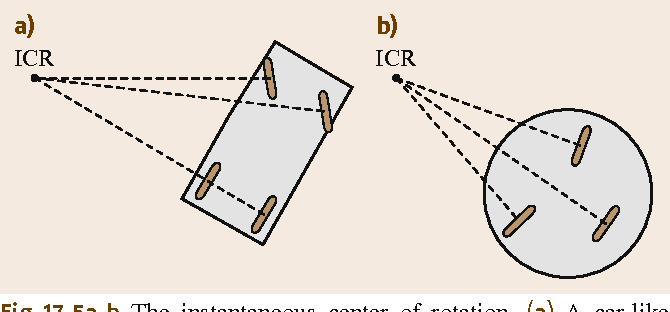

So this is not ICR?
Ackermann-steering-geometry-used-in-car-like-wheeled-mobile-robots-B-is-the-distance.png
  • #43

It may be. Or not. How can you tell from some pictures with no context? But if they mark it as ICR it may be. It does not mean that is the same point as the center of the the trajectory described by the COM. These are distinct points in general. They may be same in some situations.
how do you mean "with no context"?
This is center of curve, that point is at rest in space-time. Time passes but the coordinates remain the same.
Isnt it?
