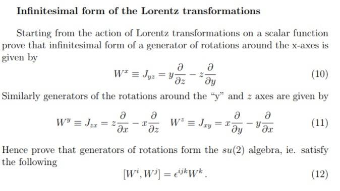

attached:
where ##J_{yz} ## is
[/B]

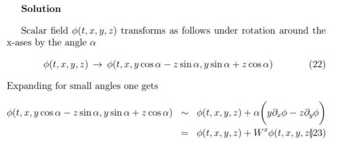

In a previous question have exponentiated the generator ##J_{yz}## to show it is the generator of rotation around the ##x## axis via trig expansions
so ##\Phi(t,x,y,z) \to \Phi(t,x,y cos \alpha - z sin \alpha, y sin \alpha + z cos \alpha ) ## and so via small angle expansions have:
##y \to ( y(1-\frac{\alpha^2}{2}+O(\alpha^4))-z(\alpha-\frac{\alpha^3}{3!}+O(\alpha^5))) ##
and
## z\to ( ( z(1-\frac{\alpha^2}{2}+O(\alpha^4))+y(\alpha-\frac{\alpha^3}{3!}+O(\alpha^5)))##I am unsure now how expand. I thought perhaps a taylor expansion in multivariables - y and z- was the idea, but I can't see how you would arrive at the answer attached with this:
Any tips appreciated.ta.

binbagsss said:
attached:View attachment 227270
where ##J_{yz} ## is View attachment 227273

It is far easier, although not really short. Simply apply ##[W^i,W^j]=W^iW^j-W^jW^i## to a function ##f(x,y,z)##.
There's a typo in the solution you attached. Is that what's confusing you?

I'm not sure whether this is giving too much of a hint on the first round, but here it is...
For a 1-parameter coordinate transformation ##x^\mu \to x'^\mu(x,\alpha)##, where ##\alpha## is the parameter, and ##\alpha=0## corresponds to the identity transformation, the generator ##G## can be computed from the following formula:$$G ~=~ \left. \frac{\partial x'^\mu}{\partial\alpha} \right|_{\alpha=0} \, \frac{\partial}{\partial x^\mu} ~~,$$(with implicit summation over the index ##\mu##).
HTH.

You just have to fill in a couple of steps in the solution you posted (which, as vela said, does indeed contain a typo).
In a little more detail, express ##\Phi'\Big(x^\mu(\alpha)\Big)## as a Taylor series in ##\alpha## (to 1st order is enough). Then use the chain rule to re-express ##d\Phi'/d\alpha## in terms of ##\partial\Phi'/\partial x^\mu## (since ##\Phi'## only depends on ##\alpha## indirectly, via the dependence of ##x'^\mu## on ##\alpha##).

I mean, we have differential operators and the multiplication times ##x_\nu##. As we are only interested in the commutator relations of them, we can simply take any twice differentiable function in three variables and calculate what these operators do. No need for any power series, the manifold itself, or a parameter. Simply differentiate: (I set ##\partial_x := \dfrac{\partial}{\partial x}\; , \;etc.)##
[W^x,W^y](f)=(y\partial_z - z \partial_y)(z\partial_x - x\partial_z)(f) - (z\partial_x - x\partial_z)(y\partial_z - z \partial_y)(f) = \ldots
I would further set ##f_x:=\partial_x (f)\, , \,etc.## to keep the workload low, but there is nothing else needed than good old Leibniz rule. It's trivial.

Oh, I see. You're answering a different part of the question.
I was explaining how to compute the generator corresponding to a particular (finite) coordinate transformation. You're explaining how to calculate commutator(s) between generators.
