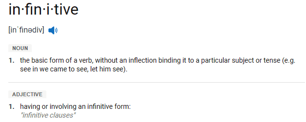

There may be some confusion here. “Infinitive” is a linguistic term about verbs. It has nothing to do with math.
