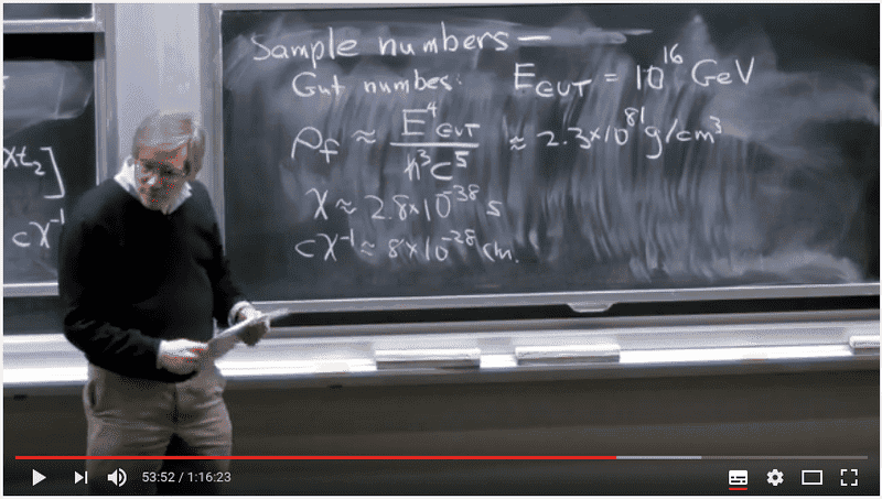

This is another question related to an undergrad video lecture on inflation by Guth. In the course, he derives the inflationary expansion rate :
a(t) ~ eχt, with χ = sqrt(8πGρf/3), and ρf being the mass density of the false vacuum energy.
Later in the lecture, around 51:35, Guth gives sample numbers associated to inflation. The starting point is based on the idea that inflation started at energies where Grand Unified Theories were valid, which is on the order of EGUT ~ 1016 GeV. From that, he deduces ρf by dimensional analysis. He then computes the inverse of the expansion rate, χ-1 ~ 10-38 seconds, and what I think is the event horizon length before inflation : c/χ ~ 10-28 cm.
Here is a screenshot (he forgot the the -1 exponent for χ ~ 2.8 * 10-38 s, he corrects it later) :
I'm ok with EGUT and ρf. What I'm not sure is what do to with χ-1. Does this represent the time at which inflation might have started ? Or the duration of inflation ? And if it is one of those, why ?

It is the time needed for the universe to increase all lengths by a factor e. Inflation lasts much longer than that.

Thank you. Is there a (simple) way we can evaluate how long inflation lasts ? And when it starts ?
If there was something before inflation, then inflation should have started at its typical energy scale.
Unfortunately we don't know how long it lasts, only lower limits can be found. The answer could be forever (eternal inflation).

Which might be EGUT ? Is there a way to put a time on that energy scale ? I read poeple saying inflation might have started at 10-30something s but I can't find the sources of those affirmations.
Do you know how we can find those lower limits ? Same thing I read durations of the order of 10-30something s but no proof is given.
Sure. The time scale for the start (if there was a start at all) depends on unknown physics.
