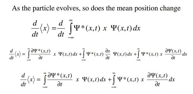

OK so originally this is what the equation looks like, if you recall I mentioned this is from my physics course in QM.
∫[itex]\Psi^{*}[/itex]([itex]\partial x[/itex]/[itex]\partial t[/itex]) [itex]\Psi[/itex] dxWhere [itex]\Psi[/itex] is the wavefunction. The thing is though, this integral has to be zero somehow because it vanishes from the rest of the explanation! I'm beginning to think there is some serious string pulling going on here and nothing formally defined but I'd like to attempt to get a real explanation either way.
And no x is NOT explicitly defined at all.

Ok look at this:

Argh! From which book is that from?
In quantum mechanics the wave function, here obviously for a one-dimensional problem, is a function of two independent variables [itex]\psi(t,x)[/itex]. The position operator in this position representation of the state is
[tex]\hat{x} \psi(t,x)=x \psi(t,x).[/tex]
The expectation value of [itex]x[/itex] is given by
[tex]\langle x \rangle=\int_{\mathbb{R}} \mathrm{d} x \psi^*(t,x) \hat{x} \psi(t,x) = \int_{\mathbb{R}} \mathrm{d} x \; x \psi^*(t,x) \psi(t,x).[/tex]
Now you take the derivative of this expectation value with respect to time. Only the wave function depends on time, not the variable [itex]x[/itex] under the integral! Thus the correct statement is simply
[tex]\frac{\mathrm{d}}{\mathrm{d} t} \langle x \rangle= \int_{\mathbb{R}} \mathrm{d} x \; x [\dot{\psi}^*(t,x) \psi(t,x) + \psi^*(t,x) \dot{\psi}(t,x)].[/tex]
There is no necessity to consider [itex]\partial x/\partial t[/itex] here, because these are two independent variables in this context anyway!
The really important thing is that you can write the latter equation in the form
[tex]\frac{\mathrm{d}}{\mathrm{d} t} \langle x \rangle=\frac{1}{\mathrm{i} \hbar} \int_{\mathbb{R}} \mathrm{d} x \psi^*(t,x) [\hat{H},\hat{x}] \psi(t,x), \qquad (*)[/tex]
because of the Schrödinger equation
[tex]\mathrm{i} \hbar \partial_t \psi =\hat{H} \psi[/tex]
and its adjoint
[tex]-\mathrm{i} \hbar \partial_t \psi^* = \hat{H} \psi^*.[/tex]
Then (*) means that the observable corresponding to the time derivative of the position, i.e., the velocity is represented by
[tex]\hat{v}=\frac{1}{\mathrm{i} \hbar} [\hat{H},\hat{x}].[/tex]
In this form, (*) known as Ehrenfest's theorem, and it shows some similarity with the canonical formalism in classical mechanics in terms of Poissong brackets!

So, it simply reduced to that a function averaged over the full time inteval isn't itself a function of time.
thought it might be something as trivial as that..
Yeah this is actually from my professor's slides, technically not the book verbatim but this is how she summarized it. The book actually shows something like what you described and I kind of get that though it's a bit tricky to follow.
Anywho, thanks for the replies, I guess the real problem here was my professor trying to be clever but in the end getting everyone confused. Agh this stuff is quite difficult the very first time around... sigh :/
