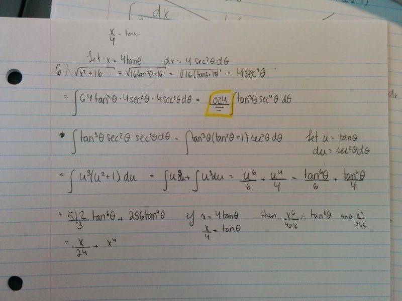

Integral of $$ x^3\sqrt{x^2+16}dx $$
answer should give
$$ 1/5(x^2+16)^{5/2} -16/3(x^2+16)^{1/2}+C $$
x=atanθ
Handwritten trigonometric substitution work on lined paper: x = 4tanθ, dx = 4sec²θ dθ, √(x²+16) = 4secθ, reducing to 1024 ∫tan³θ sec⁴θ dθ, then u = tanθ, and final result x⁶/4096 terms and x⁴/256 terms.

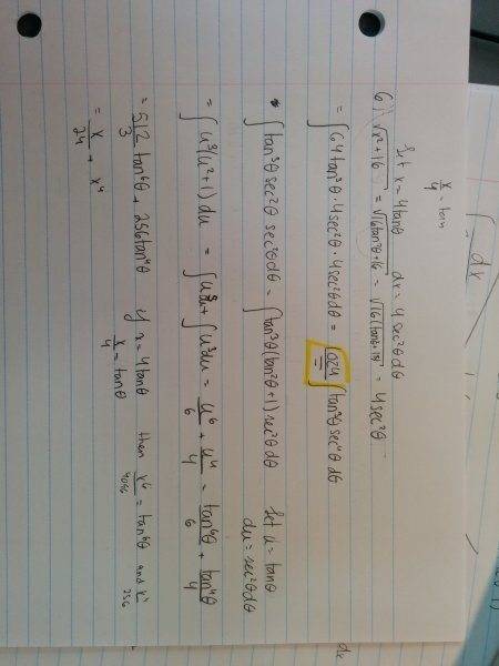

I'm trying to find the integral of the equation, but it doesn't give the same answer as the one I'm supposed to get, and I don't know what I'm doing wrong. I'm using trigonometric substitution which let's x=4sinΘ.
In the second step after you did the substitution, the whole things becomes,
4*((tan0^2)+1)^(1/2)=4sec0 and not 4sec0^2

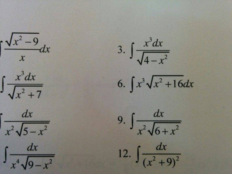

can you post the question? Like the integral you are trying to find the answer for?
Photo of a printed page listing integral problems, including the integral of x^3 times the square root of x^2 + 16 dx, numbered 6, alongside integrals of x^3 dx over the square root of 4 - x^2, dx over x^2 times the square root of 6 + x^2, and dx over (x^2 + 9)^2, and others.
No problem! I tried using Latex, but it doesn't work...It's #6

See my previous post. It's fairly clear which integral the OP is trying to find.
Thank You Mark! I'm still learning to use Latex... I changed it and it should appear ok, now!
Ok, I'm currently trying, correcting the mistake I made with my sec^2. It looks good!
I can officially say that it works now! Thank you Faris! Such a "minor" mistake that really changed everything in the problem!

He meant Question 6 from the picture

Thank you! It works now, my mistake was simply that I forgot to take the sqrt of sec^2
