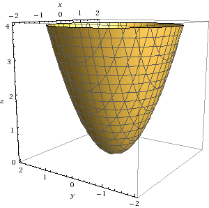

Let F = <x, z, xz> evaluate ∫∫F⋅dS for the following region:
x2+y2≤z≤1 and x≥0
Gauss Theorem
∫∫∫(∇⋅F)dV = ∫∫F⋅dS
This is the graph of the entire function:
3D surface plot of the paraboloid z = x^2 + y^2 over the region up to z = 1, shown with mesh lines, axes labelled x, y and z, z ranging from 0 to 4.
Thank you Wolfram Alpha.

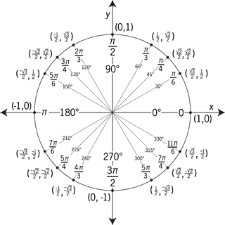

But my surface is just the half of this paraboloid where x is positive. So I thought if I looked down the x-axis I would get something like this:
Unit circle diagram with angles in radians and degrees marked at multiples of pi/6 and pi/4, with coordinates such as (1,0), (0,1), (-1,0) and (0,-1) labelled on the axes.
But only the right half of the circle (from -3π/2 to π/2)...
The integral I set up is the following:
∫∫∫xdzdxdy (x is the dot product of ∇ and F)
I converted to polar coordinates
∫∫∫r2cosθdzdrdθ
Bounds:
r2≤z≤1
0≤r≤1
-3π/2≤θ≤π/2
I ended up getting
-(4/15)∫cosθdθ
-3π/2≤θ≤π/2
(4/15)[sin(π/2)-sin(-3π/2)] = 0
Answer should be 4/15 according to the back of the book.
  • 3D surface plot of the paraboloid z = x^2 + y^2 over the region up to z = 1, shown as a gold mesh bowl opening upward, with axes labelled x, y and z.
That is not the correct range for the ##x## positive half of the circle. Do you really mean ##-\frac{3\pi}{2}##?
Well, no, it shows the region (at least, it would if truncated at z = 1 instead of z = 4).

lumpyduster said:
-3π/2≤θ≤π/2
Think about that lower bound again. Where is -3π/2 in the plane?

Not sure at all about the lower bound... Should it be 3π/2? I was going to also say 0 to π, but if my upper bound is correct then that would be wrong.
haruspex said:
That should work.
So I will integrate from π/2 to 3π/2? I guess I'm confused how to take into account that x≥0 when switching to polar coordinates. I just know I want to go from x=0 to x=1 on the Cartesian coordinate system. Would 0 to π also work?
No, you said 3π/2 for the lower bound, not the upper bound.

Yeah I probably sound like a total noob here, but I've never done an integral where my lower bound was greater than my upper bound... Will try and report back if necessary :)
You can take the lower bound to be -π/2 if you prefer. It should give the same result.

I just don't know how to get these bounds though... Can I say that since 0≤x≤1 and since x=rcosθ and r=1, that arccos(0)≤θ≤arccos1?
Thank you for your help!
Yes, but that doesn't pin down the bounds on theta. For example, π/2 to 0 would seem to be right if you base it only that. I don't think you can do better than consider what the physical region looks like and deduce the range for theta from that. Just bear in mind that running theta continuously from the lower bound to the upper bound (together with the ranges on r and z) must reach each point of the region exactly once, and no points outside the region.
