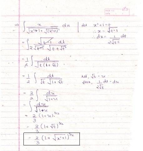

I think I have a better way.. [please see attachment] {sorry if my handwriting ain't clear..}
You made a mistake doing your final integral in the attachment. The correct result is
[tex]\int \frac{du}{\sqrt{1+u}} = \sqrt{1 + u} =\sqrt{1 + \sqrt{x^2+1}}[/tex]
(up to a constant of integration, of course).
You can then check by differentiation that this is correct.
oops.. I mistakenly took the power of [itex]1 + u[/itex] to be [itex]\frac{1}{2}[/itex] instead of [itex]\frac{-1}{2}[/itex]..
