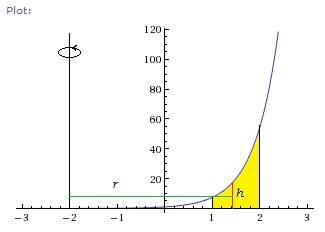

Yes, correct for the first one. Now for the second, consider the following diagram:
The region to be revolved is shaded in yellow, for an arbitrary shell, the radius $r$ is the horizontal line in green and the height $h$ is the vertical line in red. The thickness of the shell is $dx$. And so the volume of this element is:
$$dV=2\pi rh\,dx$$
If $x$ is the $x$-coordinate of the vertical line, then what is the radius when revolved about $x=-2$, i.e., what is the length of $r$? What is the length of $h$?

the radius is r=x+2 am i correct?
Yes, that is correct:
$$r=|x-(-2)|=|x+2|$$
For $x\in[-1,2]$, we have $x+2>0$ so:
$$r=x+2$$
What is $h$?
h is $e^{2x}$
then the integral should be $\displaystyle 2\pi\int_{-1}^2 (x+2)e^{2x}dx$

Yes, that is correct. (Sun)
