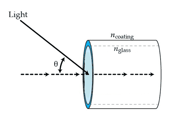

As you can see we have 3 media here. Only focus on the glass and coating medium. Assume an incident ray comes from the air medium and is refracted inside the glass and then it is refracted again in the coating medium. The x angle is the angle inside the glass medium. In this case, if the incident ray,from the air, enters the glass it will create a refracted ray with an angle. This is the x angle. Now, let's say I want the refraction angle of the coating medium to be 90°. Why do I have to subtract 90° from the x angle to achieve this?
nglasssin(90°−x)=ncoatingsin(90°)

Look at your equation, without the [itex]90^\circ[/itex] shift, you'll have a negative answer, i.e. a negative index of refraction.
It's because of the way the angles are defined. Angle of incidence and angle of refraction are the angles relative to the surface normal. That picture defines ##\theta## as relative to the horizontal, which is tangent to the surface. The angle of incidence is ##90^\circ - \theta##.

Your angle θ in the diagram needs to be modified to be the angle between the ray and the Normal to the surface (i.e. 90-θ ). It's the angle from the normal of the surface that is what's in the standard version of Snell's Law, which gives you the Critical Angle.
A thought:
Why do we use the normal and not the angle from the tangent?
There is only one Normal but there are any number of possible tangents for aspherical surfaces - so which tangent could you use? The Normal comes to the rescue.
