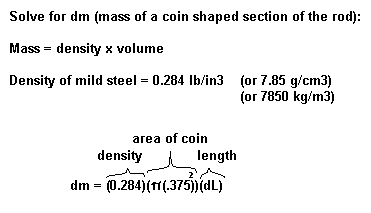

Next I moved on to try solving for the change in internal energy dE. I got the density ρ from wikipedia, the specific heat C from this website, and all that was left was dm and (dT/d∅).
I wasn't sure what to do for (dT/d∅), so I tried dm:
The only one I feel somewhat confident in is what I have for dm. But I'm still not exactly sure about everything, and I'm not sure what to do next.
The roadblock I've encountered is that I haven't taken Differential Equations, so I don't know how to solve an equation like this.
For these temperatures and the fact the rod is in air, the overall heat transfer coefficient is on the order of 1 BTU/hr-ft^2-R. You can change the units. We'll get to the boundary conditions once some things get cleared up. But the above will let you determine the Biot number when put in appropriate units.
Your dm is correct.
Your energy change is correct. Once you have the boundary conditions (heat added per unit time), equate them to dT/dtheta multiplied by rho, C, dm.
