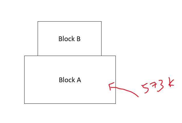

Hi guys, I'm a 2nd year mechanical student currently taking heat and mass transfer. A question came up in my mind when I was looking into the conduction heat transfer.
If I put block B on block A where block A is 573K and block B is 303K. Is there any way that I can calculate the time required for block B to be heated to a certain temperature let's say 398K?
I understand that the conduction equation is Q/t = kA((T1-T2)/L). But I really wanted to know how can this be used to solve the problem above.
I would really appreciate it if anyone could help to clear my doubt.
Do you think the temperatures in the two blocks will be uniform spatially during the equilibration? Are you familiar with the transient heat conduction equation?
Try making some simplifying assumptions as a first model:
Blocks with very large thermal conductivities ##k##, and reasonably sized blocks should imply spatial thermal gradients to be negligible. What this says is that the Temperatures ##T_A, T_B## are uniformly distributed throughout each block at any time ##t##.
For simplicity, assume conservation of energy between the two blocks (the two blocks are the entire system). What that means is the heat absorbed by block B from block A, is exactly the heat lost from block A.

And for the dynamic portion try applying a surface energy balance at the interface of blocks A and B using a thermal contact resistance type model.
$$ m_B c_{p_B} \frac{dT_B}{dt} = \beta \left( T_A - T_B \right) \tag{2} $$
## \beta## is a parameter that would depend on the area of contact and the pressure of contact.
Using ##(1)## and the initial conditions ##T_{A_o}, T_{B_o}## you can solve ##(2)## for the time ##t## needed for block B to reach a particular ##T_B##.

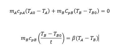

Hi erobz, thank you for your reply and sorry for the late response. Your explanation is clear. I would like to ask so if I would like to use the equations that you provided above, It will be solving like this right?
Close, but the second one is going to be an ODE ( linear - first order - non homogeneous). What you have written assumes the rate of change in temperature is constant in time.
Solve ##(1)## algebraically for ##T_A ## as a function of ##T_B##.
Then you plug that result into ##(2)## ( eliminating ##T_A## ) and solve the resulting ODE by standard methods.

Alright, erobz thanks for correcting me! I understand that the rate of change in temperature is variable in time. But I'm curious and just want to ask if I assume the rate of change in temperature is constant in time, will I get any approximate result?
I doubt it. You probably won't even get an approximate result if you solve the ODE as it is. You could amend the system of equations to account for "real world" stray heat transfer to the environment from both blocks, but it's going to get more involved. I'm afraid in the end (as I think you will find out) heat transfer is messy business...that requires painstaking tedium to get half-truths at best. Thats my opinion of the subject, the experts probably disagree, but...
I'll share with you the solution I get with the model as is:
With
##\beta## a parameter with units ## \rm{ \frac{W}{m^2 K}}##
##\gamma = \frac{m_B c_B}{m_A c_A}##
##A_c## is the contact area
## T_B## is temp of the block at time ##t##
$$ t = \frac{1}{\beta A_c} \frac{m_B c_B}{1+\gamma} \ln \left( \frac{T_{A_o} + \gamma T_{B_o} - \left( 1+ \gamma\right) T_{B_o} }{ T_{A_o} + \gamma T_{B_o} - \left( 1+ \gamma\right) T_B } \right) $$
This model is valid for block B temperatures ##T_B## in the range:
$$ T_{B_o} \leq T_B \leq \frac{ T_{A_o} + \gamma T_{B_o} }{ 1+ \gamma}$$
You can see that there is going to be this parameter ##\beta## that you will either be able to find in literature as a contact resistance for your materials, (highly doubtful) or this is the parameter you would determine from experimental results.
