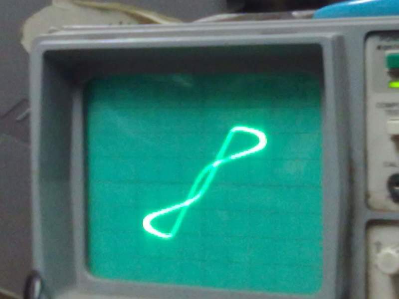

We attempted to trace the B-H curve of soft magnetic material by using principles of electromagnetic induction. Attached with this is the curve obtained. I am unable to figure out why am I getting the two loops at the end?
Please help

Welcome to the PF.
Can you post a diagram of your test setup? What exactly are you plotting on the x-y axes of that oscilloscope?

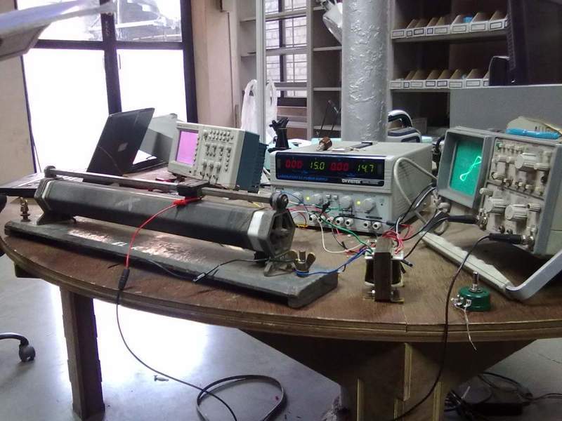

We are using the principle of Electromagnetic induction to trace the bh curve of the soft magnetic material ( Mu metal) . The test setup consists of a primary and secondary coil..The primary coil is wound on a aluminium rod of square cross section. The input current is controlled through a resistor in series with the primary coil and the frequency of input current is 50 Hz. The hysteresis material on which the secondary coil is wound is placed in the solenoid. The hysteresis material is in the form of rod having circular cross section of length of 1.1mm x 80 mm. The emf induced in the secondary coil is given to the power amplifier and then to the integrator. The integrator output is plotted on the Y axis and the input current given to the primary coil is plotted on the X axis of the CRO.

Well what an interesting setup you have there !

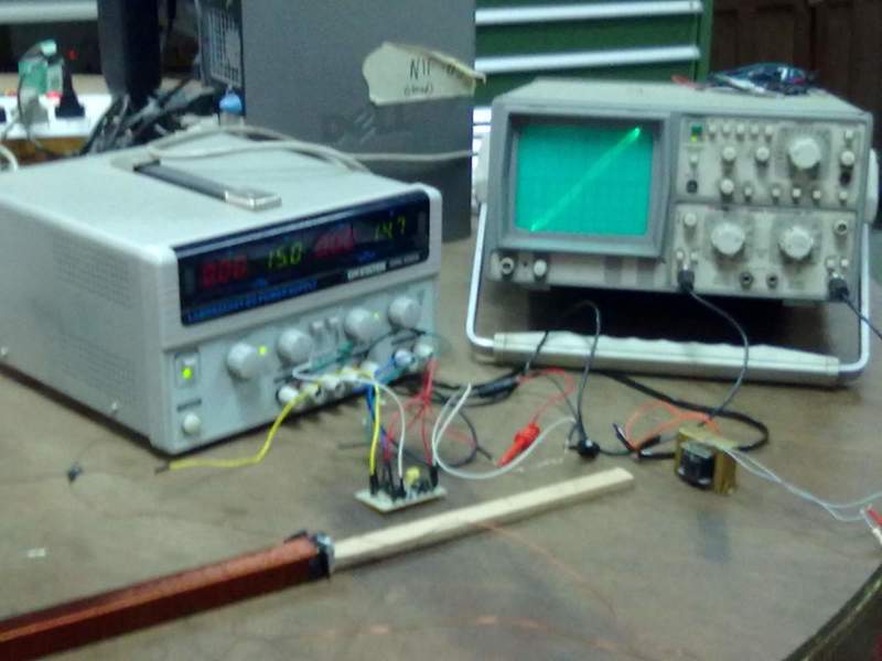

That trace attached to your new post has no loops on end - what is it? Your setup with core not inserted perhaps? Or did you solve the mystery already?
(I assume your amplifier has high input impedance so there's not much current in sense coil compared to excitation coil.)
Since your excitation is sinewave, set your 'scope for ordinary time display and observe current & induced voltage as you slide the core into the solenoid.
Then take a look at input and output of "power amplifier" .
As core is inserted the induced signal gets much larger and we should look to see if we are overdriving that amplifier... if output sinewave peaks flatten out you are saturating the amplifier. You shouldn't be able to saturate an iron rod since so much of the magnetic path is through air.

With an ideal inductor current and flux would be in phase and your test would show a straight line on your oscilloscope. That's what you'll get with air core and that's almost what the more recent trace looks like...
With real inductor you have hysteresis so expect a B-H loop.
Inside real iron you also have eddy currents which retard the flux because of Lenz's law.
Recall Gauss' h(dot)dl = ienclosed counts ALL the current, not just what current you applied. If you use a voltage sensing coil to measure flux, even the current flowing in it counts.
Your 'scope trace on second post shows a small loop - if it's not your successful B-H loop, then perhaps it's just a little phase shift from eddy currents in your aluminum coil form or imperfect integration, or perhaps even an iron leg brace on bottom of work table underneath your solenoid. So take a look at table's underside..
Also note the aluminum coil form constitutes one shorted turn, if that turns out problematic maybe you can find some square plastic or use balsawood??
