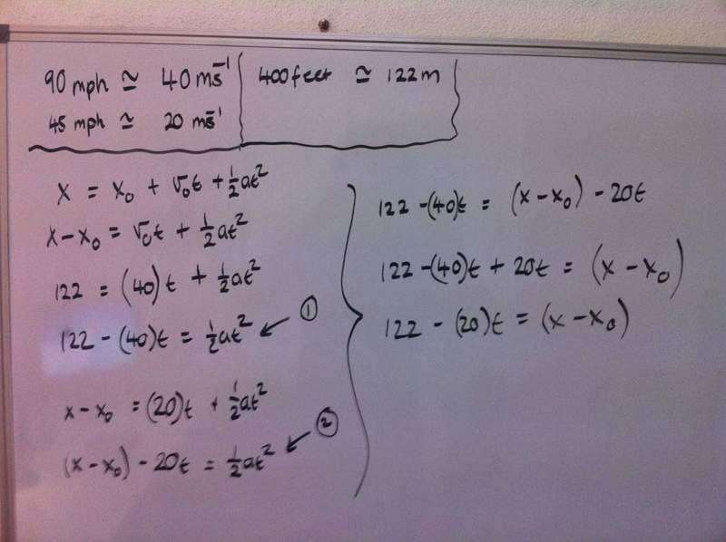

I just attempted to solve the problem using your method, but am left with a variable of time which we have no way of getting without the acceleration. I attached a photo of my workings using your method in case you're interested. (I'm from Australia so I converted the units to metres and metres per second)
If you need any more help let me know. :)

Ok I see my dumb mistake now. I don't know why but I canceled the seconds out with the time. But now I see that time is not just seconds because for all we know it can be an interval so I can't just cancel out the "t" with the "s". Ok I'm going to go ahead and try the other formula you suggested. Thanks again for the detailed explanation; I probably would have never seen that horrible mistake.
No worries mate! We all make mistakes. It was a good attempt though!
