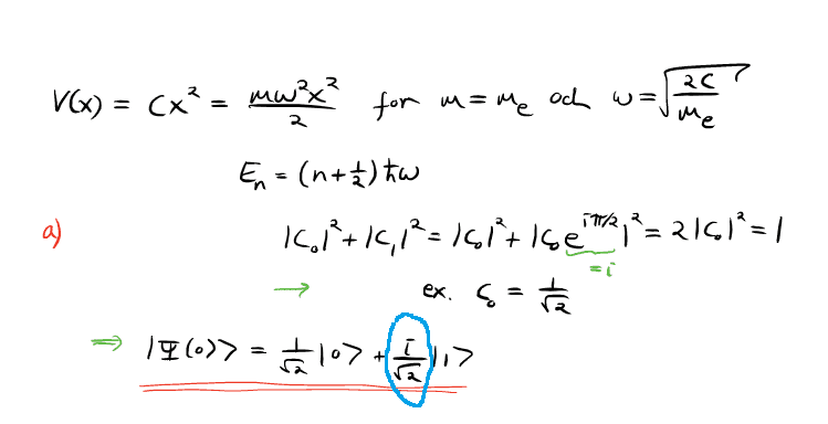

See pic
See pic
I can't figure out how they get i/sqrt(2) for normalisation of c1. Why is it a complex number? If I normalise c1 I just get 1/sqrt(2) because i disappears in the absolute value squared.
Thanks
It looks like you left out other information from the problem, but apparently, there was the relation ##c_1 = i c_0##. That's where the ##i## comes from. Note that you had to have this relationship to solve for ##c_0##
otherwise you'd have two unknowns but only one equation.
There was this relation:
Aha, so the exponential is also interpreted as i then. Thanks, got it!
##e^{i\pi/2}= \cos (\pi/2) + i \sin(\pi/2) = i##
##e^{iv}= \cos (v) + i \sin(v) ##
