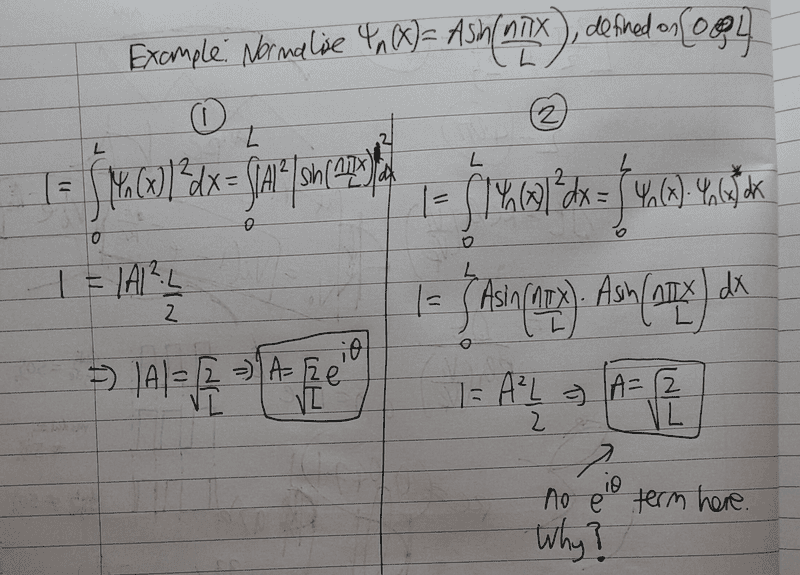

Take, for example, the below wavefunction. With method 1, I get an extra phase. With method 2, I do not. (In method 2 I admit I forgot the negative root, but even so, that's only 2 values of theta, namely, 0, and pi.) Why does method 2 not yield that e^i term? Also, I realise this is kind of a "homework" question now so I might be in the wrong thread.
You do if you realise that A is (or may be) complex. So in your integral there should be A*, and that yields |A|^2, and so on. Btw, both of your 'methods' are exactly the same, since |z|^2=zz*. You just wrote out different steps in left and right columns.
