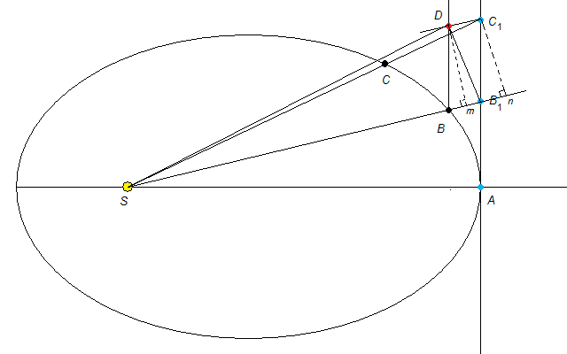

Let us prove this (straight from Feynman's lectures):
S represents the Sun. According to first Kepler's Law, the planet moves along an elliptic trajectory ABC.
If the Sun did not attract the planet, it would continue moving along the straight line AB1C1 traversing equal lengths in equal time intervals (principle of inertia) so that AB1 = B1C1. But, then, the areas of the triangles SA1B1 and SB1C1 are equal. Why? First they have equal bases AB1 = B1C1 and second, they have the same height dropped to these bases (in the figure, the line SA).
But the Sun does attract the planet. In order to make an approximation, we will assume that the displacement due to this attraction at point C1 is equal to the exact displacement at the midpoint B1, namely B1B. We translate this line parallel to get the line C1D. Thus we obtain a parallelogram BB1C1D. In this way, we approximated the true part of the trajectory of the planet ABC by a broken line AB1D. It is obvious that these are never equal. Nevertheless, when we make the lengths AB1 = B1C1 infinitesimally small, we make an error in area one order higher and, thus, becomes negligibly small.
Let us show that the area of the triangle SB1D is equal to the area of the triangle SB1C1. The both have the same side SB1. Also, the heights dropped to this side (Dm and C1n respectively) are equal because they are opposite sides of another parallelogram DmnC1. Therefore, the areas must be equal. Q.E.D.
