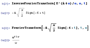

Hi there. I have some trouble with this. I have to find the inverse Fourier transform for: \frac{e^{i 6\omega}}{\omega}
So I'm using a table, then:
F^{-1}\left ( \frac{e^{i 6\omega}}{\omega}\right )=F^{-1}\left ( e^{i 6\omega}\right ) * F^{-1}\left ( \frac{1}{\omega}\right )=2\pi\left[ \delta (t+6)*\frac{i}{2}sg(t)\right] where (*) represents the convolution.
Well, everything fine till there, but when I tried to corroborate my result with mathematica I get:
I don't know what's wrong.

Yes, I think I made a mistake. I don't know how Mathematica arrives at that result.
Yes, I don't know neither. And actually the problem is I don't know where I have the mistake, I think that my solution is fine, maybe I'm not doing it well in mathematica, I'm thinking that there are different ways for defining a Fourier transform. You can use the frequencies or the angular frequency. Maybe I'm just not doing it well with mathematica, perhaps I have to define something else, that's a possibility.

If you're just wondering about the constants out front, you have to remember there are various conventions of where to put the 2\pi. Mathematica has a parameter called, appropriately enough, FourierParameters that you can set depending on which convention you want to use.
Thank you vela :) do you have any idea about how mathematica gets to that? I think I should read more carefully the help content on this topic, but I don't have to much time for this, so maybe if you know the underlying formalism for this I'll appreciate if you let me know :P
Does it have any sense the solution with the heaviside function that Ray found using Maple? that's not a constant difference, but I'm aware of the similarities between the unit step function and the sign function, they differ only for the negative real values (I have no idea about what happens on the complex field).
By default, this is what Mathematica uses for the inverse Fourier transform:
f(t) = \frac{1}{\sqrt{2\pi}}\int_{-\infty}^\infty F(\omega)e^{-i\omega t}\,d\omega
So Mathematica would give you, for example,
F^{-1}[e^{i6\omega}] = \frac{1}{\sqrt{2\pi}}\int_{-\infty}^\infty e^{i6\omega}e^{-i\omega t}\,d\omega = \sqrt{2\pi}\left[\frac{1}{2\pi}\int_{-\infty}^\infty e^{i(6-t)\omega}\,d\omega\right]
where the quantity in the square brackets is the Dirac delta function \delta(t-6).
From looking at the results you found in the table, I think you're using the convention
f(t) = \int_{-\infty}^\infty F(\omega)e^{i\omega t}\,d\omega
If you look in the Mathematica documentation on integral transforms, there's a list of what you want to set FourierParameters to to follow the convention you're using in your class.
As to the unit step and sign functions, they're related by a vertical shift and vertical scaling. You should be able to figure that out pretty easily.
