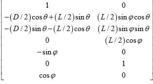

Hello
Suppose if have a matrix that is purely diagonal with NO zeros: M (which is n by n -square)
Suppose I have another matrix the contains coordinate information, call it A.
This one is NOT a square matrix, but, (n by m) (where, in general m < n)
I form this: Q = A-transpose * M * A
(where Q is, of course, m by m)
How can I be sure Q is invertible?

Yes, I see that. That is my point. What restrictions are on A? I can see that is one
But this FINAL matrix Q, is the coefficient in a diff.eq like this
Q x-double-dot = F(sorry I cannot seem to get latex to put the double dot over the x)
Where Q is the product above.
How can I be sure it is invertible? It seems to always be. The Mass matrix consists of mass and moment of inertia terms on the diagonal

OK, I will summon up the courage to reveal how dense I am, with questions
1. This A matrix maps a set of minimal generalized coordinates to Cartesian coordinates. How does one know such a matrix is injective?
2. How do you know that A-transpose is NOT injective
3. WIth the middle term being a diagonal matrix (of no zeros) can you state that there is a proof that the final Q is invertible? The proof is likely beyond me, but I want to know it exists.

I attach a picture of one such A matrix. The result IS invertible (for when the middle matrix is 7 by 7 diagonal)

You are right, I made a mistake. We have
\mathbb{R}^2\stackrel{A}{\longrightarrow}\mathbb{R}^5\stackrel{M}{\longrightarrow}\mathbb{R}^5\stackrel{A^\tau}{\longrightarrow}\mathbb{R}^2
So if ##A## is injective and the restriction ##\left.A^\tau\right|_{\operatorname{im}(MA)}## is injective, too, then we can invert the combined function. My mistake was to concentrate on the five dimensions in the middle. But if we ignore this fact and only regard the two dimensions left and right, then we can invert the combined function if those conditions hold. They hold in your example though. Sorry.
It won't work with ##m>n##.

I will try. But you obviously caught me on a bad day. Let's see. (It will take a while to type and check.)
Edit: Couldn't you simply multiply ##A^\tau MA##? Otherwise we have to check whether the restriction of ##A^\tau## to the image of ##MA## is injective.
Let's abbreviate ##a:=\frac{D}{2}## and ##b=\frac{L}{2}## (easier to type).

Unfortunately there is little we can do from here on as long as ##a\neq b## and the diagonal entries ##m_i## of ##M## are all different. This means you will have to calculate those monster terms and examine the question:
Under which conditions is ##p_{11}\cdot p_{22} - p_{21}\cdot p_{12} \neq 0\;##? These will be the cases where ##A^\tau MA## is invertible. If the ##m_i## were all equal or ##a=b##, then we would get a lot of terms ##c\cdot(\cos^2\psi +\sin^2\psi )=c## and things would become easier, but without this knowledge, the monster has to be analyzed.
Maybe someone else has another idea. But to calculate the image of ##MA## and see whether ##\operatorname{ker} \left.A^\tau\right|_{\operatorname{im}(MA)}=\{0\}## doesn't seem to be easier.
