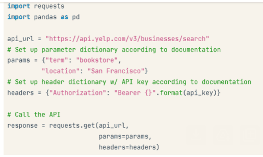

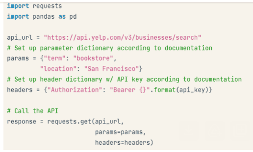

My confusion stems from hearing people saying that they use this or that API, for example the API specific to a website server (ex: Youtube API, Twitter API)...Some people talk about building APIs which made me think that API are actual programs/code that developers write...
It's still programming and coding being written, it's just that an API's specific purpose is as an interface to some black box. You only want to expose the functionality other developers need to access your resources safely.
Yes, but you don't use those APIs just to look at videos on YouTube or read posts on Twitter. (There might be Javascript code inside those websites that uses the APIs for those sites, but you aren't writing that code, you're just using the website.) You use those APIs to do things like write third-party client apps that do things like upload your own videos to YouTube or upload posts to Twitter.

I am appreciating more and more what API do and how ubiquitous they are...There are physical APIs and software APIs (which we are discussing). Anything that abstracts aways something else and let's us use it without worrying about the underlying functionalities and details represents an API.
  • For example, the knobs on a radio are APIs....The power outlet is example of a physical outlet (we get electricity from it and don't care about all the details about the power plant and transmission lines). Inside a computer, I am sure some there are many software APIs that let components communicate with lower-level hardware. In programming, a library is sometimes called an API (ex: Keras is an API for Tensorflow, Seaborn is an API for matplotlib, etc. since they allow us to use those libraries/frameworks in a more convenient way...). Even a simple python function that converts a string from lowercase to uppercase is an API in a sense since we simply call the function ##upper()## and it does its job but we have no idea of how happens under the hood.
Back to web APIs, let's review the big picture: we have remote server and a client. The client makes a request using HTTP (a protocol that seats on top of TCP). The server responds providing the "resource". The resource can mean a lot of things. It can be a webpage, some data, or even a service (ex: we send data to be processed on the server and sent back to us). However, I realize that not all client-server communications involve an API...For example, the typical request of a webpage does not involve the browser (client) to interact with an API. I think the browser interacts directly with the server...
We have said that an API is really a set of rule, functions (sort of a protocol) for two programs to communicate and exchange information/resources. The final recipient of the requested information may be a computer program but also a human user (even if an API is not a user interface UI). Thinking of a hypothetical app on our phone, the app probably uses an API to get music files stored on a remote web server and then let's the human user listen to the music (Shazam probably works like that) so the end beneficiary in this case is the human...
  • One ore two APIs? are there one or two APIs, one on the server side and one on the client side, or just one API? Does it depend on the API? Server APIs expose endpoints....How would a client-API work? For example, are Google Maps APIs client-APIs or server-APIs?
  • Python script: the short python script in the attached figure represents an API call to the yelp server...An API has a URL (URI) that specifies both the IP address the API endpoint, and possibly other parameters. When working with the requests library, we can use the HTTP verbs like GET, PUT, DELETE, etc. Here we use GET to get some information back as a json file. We are essentially using a python library, requests, and its functions get to perform the communication. But this code snippet is NOT really the API itself...even if we described an API as a simple set of rules implemented by the functions of the library requests, correct?
Analogy: finally, we know that an IP address identifies a specific host on the Internet and the port number identifies the specific service offered by the host. For example, port 80 is the door that a client knocks at to get web-like information from a server....The analogy is that the IP address identifies the house and the port identifies one of the house access doors to different rooms in the house where different resources are stored...Using this oversimplified analogy, what would an API and an API endpoint represent?
THANK YOU!

Hello again. I did some more reading....It seems to me that a public, server-side web API is really like an intermediary program/software that contains functions that can be used by a client program to interact with and ask for specific resources to a remote web server (the resources are truly located on a database connected to the web server). For example, in Python, we can write a script containing a bunch of function definitions to use/import later in other scripts. So I am thinking about an API as a set of functions used by the client. These simpler to use functions essentially wrap more complicated actions executed by the server. By example, let's think about the libraries keras and Tensorflow TF: Keras is an API for TF since it has functions to make TF do complicated things. Keras' functions indirectly use TF functions that would be harder to use for....
So there are really 3 programs: the web client program (an app we develop, a local python script, etc), the remote web server program, and the API program (the collected API functions must constitute a program) which is saved/ocated on the same physical machine as the web server program.
What if instead of asking a web API for structured data, which would be sent back to the client as json or XML file, the client was requesting unstructured data like images or audio files? How would the data be sent back? REST APIs provide the requested content in the form of json files...What data format would be used for unstructured data?
In regards to API's URLs: APIs have URLs just like regular webpages. the client program, like the browser, uses HTTP and the API's URL to use the API. Lots of things on common. The main difference seems to be the type of data sent back to the client: markup document in the case of a webpage. But a browser could also request a pdf file, which not markup language...There is not API involved there, correct?
URL are just IP addresses. Therefore an API has an IP address. Is the API's IP address the same IP for the remote web server? Do APIs also have ports? I don't think so. API simply translate the client's request to the web server...somewhere in there, the correct port must be specified based on the requested information...
