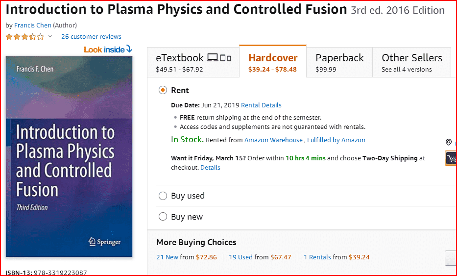

Good for you. You will need to continue learning physics, with a concentration on plasma physics. Once you are able to understand Chen, you will be in a good place to join a research team:
https://www.amazon.com/dp/3319223089/?tag=pfamazon01-20

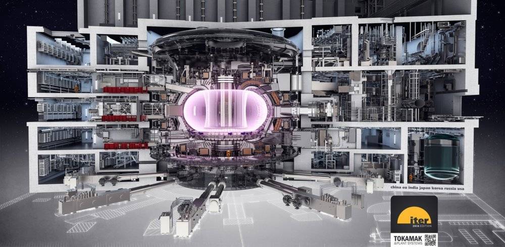

I like this book!And I often get up to http://www.iter.org/to to check out the structure of a fusion reactor. But I am considering of the “the larger the better” because huge reactors such as ITER have no mobility and low energy density. Certainly you can’t put it on a spaceship or something. However this might be caused by heat transfer of the reaction chamber.
Current designed fusion power plants such as the DEMO, something even larger than ITER and generates 2 gigawatts of power, all of them use the heat on the wall of reaction chamber to boil water and power a bulky turbine. This makes no sense! All D-T fusion release a photon with a energy of 17.8Mev, and that photon needs to hit and heat the reaction chamber then boil the water and power the turbine, then us the torque to power spinning magnets and generate power. The huge energy loss makes reactors seems not as powerful as 9 million times the power of coal, there are even more if we consider the neutron radiation.
However the reaction only release gamma ray photons with a certain energy level, this is extremely convenient for light-electric covertion and should be able to boost its efficiency to more than 50%, same or even better than the “spectrum-dividing” solar panels! If this technology is available, maybe commercial fusion energy is possible in a decade or two.
If you did achieve that, and if the other 50% went into heat, wouldn't it melt the structure in a short time?
If the other 50% pass through the structure and don't make heat, then won't the gamma rays kill the astronauts?
Ah Xforce . . you really need to learn the basics about nuclear fusion and understand the difficulties which have led to extremely large experimental machines. If you're serious, I'd recommend a graduate degree in Nuclear Engineering specializing in Fusion. I have done this, long ago, so here you go:
DT fusion releases most of its energy in the form of a high energy neutron (14.1MeV), and the rest (17.6-14.1) as a high speed alpha (4He) particle. There are no photons involved. Temperatures involved are in the 20 to 100 Million K range...
You cannot have any success doing anything 'nuclear' at home, no matter how much you 'wish it to be otherwise'.
A small fusion reactor currently only exists in the realm of sci-fi and movies (Mr. Fusion from 'Back to the Future'). The smallest fusion device made is relatively compact, but impossible to make into a power reactor. This is called a Hydrogen Bomb...
