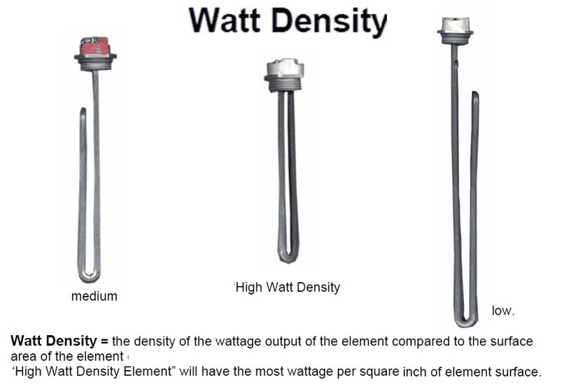

Was curious if induction water heaters were a thing and if they had any benefits over a traditional electric resistance coil. On quora someone argues that a resistance coil is a near perfect conversion of electricity to heat, therefore no benefit to induction - is this correct? Is the efficiency gains in induction cooktops solely due a more to less waste heat between the coil and pan than with a resistance coil? But then if induction transfers heat more efficiently to the metal surface on a cooktop, why not in a water heater?
In almost every water heater I every knew about the heater coil is completely submerged in the water. There is nowhere for the heat to go except into the water. That isn't the same as a cooktop. I fail to see any advantage to the greater complexity of induction heating compared to a submerged resistive heater. Someone on quora was correct, resistors are the simplest, most efficient way to convert electricity to heat.

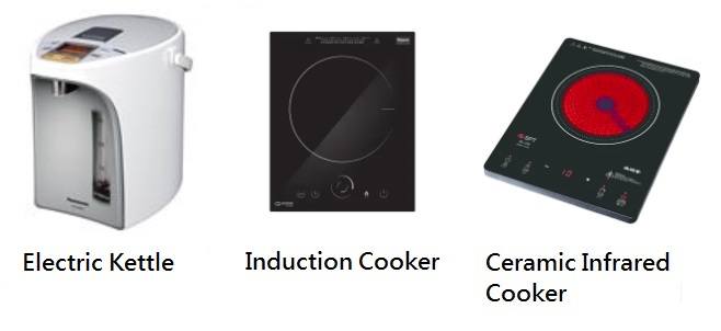

Induction stoves/cooktops are safer as far as burning/cooking small children.
They boil water faster, have a small induction hot plate alongside my gas cooktop that I use for pasta
Makes sense, thanks

Regarding the ways to make water boil, according to my personal experience, electric kettles have the highest efficiency, followed by induction cookers, and the least efficient are ceramic infrared cookers.
