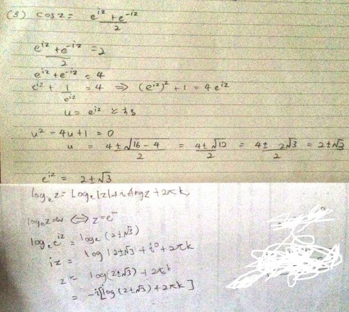

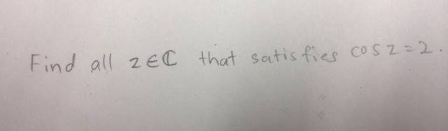

Hello.
Can someone please check if I did this correctly. Question and my attempt are as the attached.
  • Handwritten exercise on white paper: Find all z∈ℂ that satisfies cos z = 2.

  • Handwritten solution to cos z = (e^(iz) + e^(-iz))/2: substituting u = e^(iz) gives u^2 - 4u + 1 = 0, u = 2 ± √3, then taking logarithms to find z = -i[log(2 ± √3) + 2πk].

Looks alright to me, but in future - no pressure, mind, just a suggestion - if you were to take the time to learn a little LaTex and write it so, you'd probably get a faster response on here. General rule of thumb: make it easier for others to read, and you'll get more and quicker replies. (Sun)
All the best!
Gethin :D
I try to avoid the complex logarithm where possible. Since you know that $\displaystyle \begin{align*} e^{i \,z} = 2 \pm \sqrt{3} \end{align*}$, a real number, that means z must be purely imaginary, and you can solve as you would real numbers, just remembering that your value of z will be periodic every $\displaystyle \begin{align*} 2\pi \end{align*}$ units. So
$\displaystyle \begin{align*} e^{i \,z} &= 2\pm \sqrt{3} \\ i \,z &= \ln{ \left( 2 \pm \sqrt{3} \right) } \\ -z &= i\ln{ \left( 2 \pm \sqrt{3} \right) } \\ z &= -i\ln{ \left( 2 \pm \sqrt{3} \right) } \end{align*}$
and remembering that it is multivalued, that means the complete solution is
$\displaystyle \begin{align*} z = -i\ln{ \left( 2 \pm \sqrt{3} \right) } + 2\pi n \textrm{ where } n \in \mathbf{Z} \end{align*}$
That's pretty much my mantra too. But if in Rome, at least go for the principal value... (Coffee)
