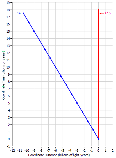

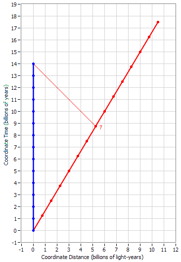

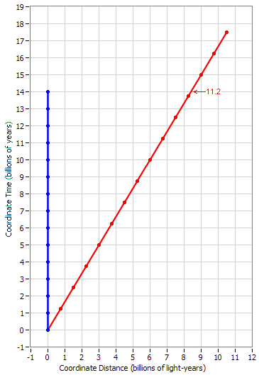

Maybe some spacetime diagrams will help to show what the problem is. Let's just consider two clocks that end up colocated with widely separated solar systems but which have been traveling away from each other at 0.6c. Let's also say that both clocks have accumulated 14 billion years, Ours is shown in blue and the distant one is shown in red:
Since we measure the age of the universe (according to our stipulation, assuming you have agreed with it) to be 14 billion years by measuring the temperature of the universe, we have to ask what an observer at the other solar system will measure at the same time. Isn't that what a universal calendar is? As you can see, he will measure 11.2 billion years.
But what if we go to his rest frame:
Now we will say that he will measure 17.5 billion years when we measure 14 billion years. Now maybe you will object that since the universe "really" is only 14 billion years old that I should not have extended the length of the other worldline out to 18 billion years, and that now for him should "really" be limited to 14 billion years. And I would rebut by saying how can you say that the other solar system even exists right now? When we look at it right now we see it at 7 billion years old as this spacetime diagram indicates:
So the issue that I am trying to get you to address is that even if the measured temperature of the universe correlates to its age, you still have to find an agreement on which reference frame to use and which Coordinate Time in that coordinate system you are going to apply to the age of the universe so that you can call it a universal calendar. I don't know what you mean by universal calendar if it doesn't yield the same answer for all observers "at the same". If you are saying that it simply yields the correct answer for all observers at different times, then I don't know why you are calling it a universal calendar.
And I still don't know what any of this has to do with the Twin Paradox.
